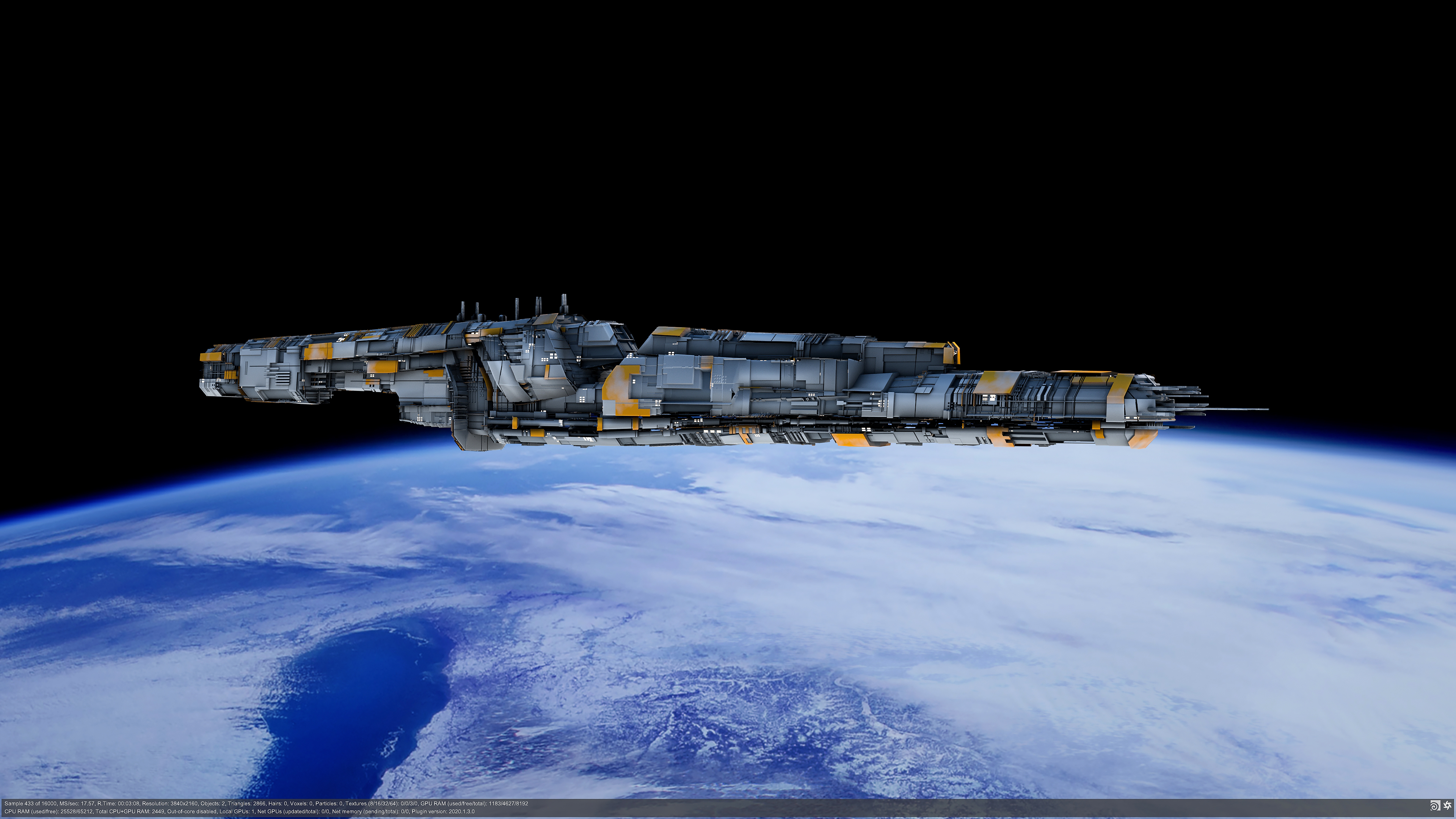

I followed the suggestions by Midphase and have this render so far:
I added some noise to get the dirt and lights to the tips.
Critique and suggestions welcome!
Edited by mkingsnorth - July 13, 2020 13:24:55
327 posts
Joined: May 2016

833 posts
Joined: Jan. 2018
Looking good. I wonder if there is any way for you to be able to define exactly where the emission textures are placed? Say for instance, in your image above, that the rear of the ship is just massive engines and probably don't have windows, but the mid-section would be where all of the habitation would be, so that would have a lot more windows.
Also, in my experience, what tends to convey scale is having some really small details. Not everywhere, but the ability to have super-tiny elements of the geometry such as railings, or small antennae, etc. So for instance, if your ship up there is about 500m long, that means that your smallest element right now is probably at least 1-2m wide which looks tiny compared to the rest of the ship, but quite large compared to a human. Think more – what would a 10cm wide antenna look like? Or a 5cm railing pipe?
>>Kays

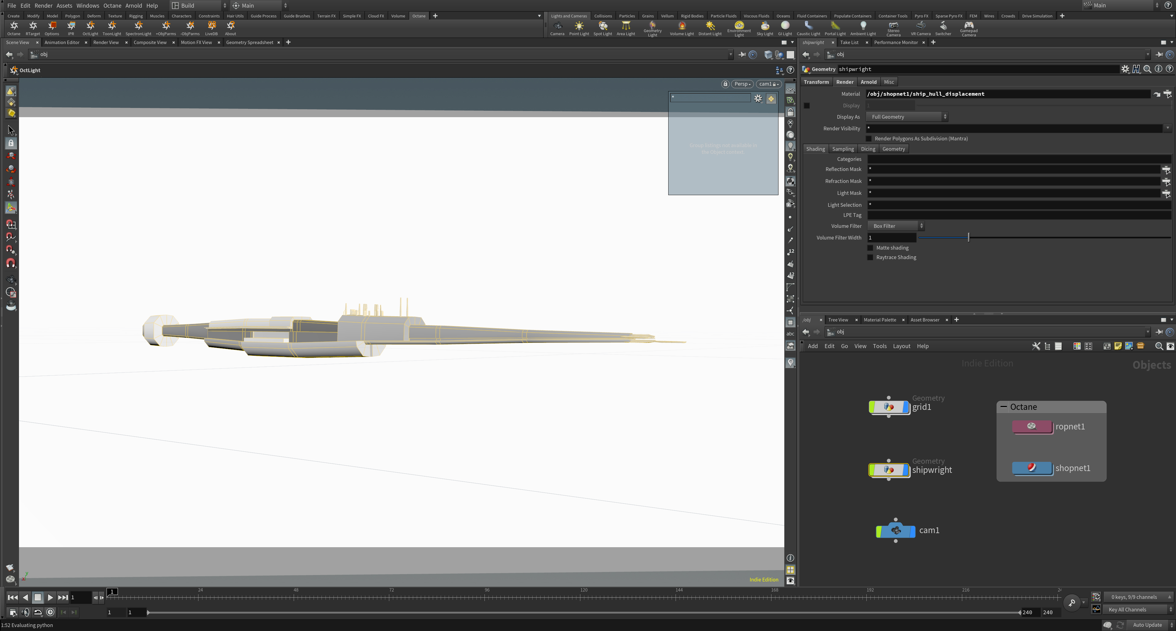

8 posts
Joined: Feb. 2020
Thanks Midphase: I've been experimenting with adding extra details and came across Octane and JSPlacement with some interesting results:
I think I could control the windows more through assigning groups based on distance from the center, yet to figure out how to get the groups into Octane though.

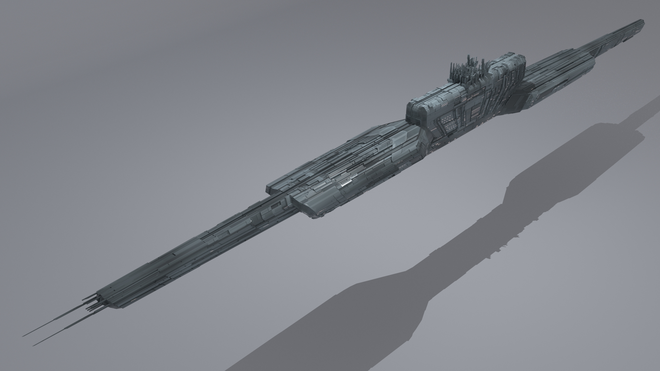

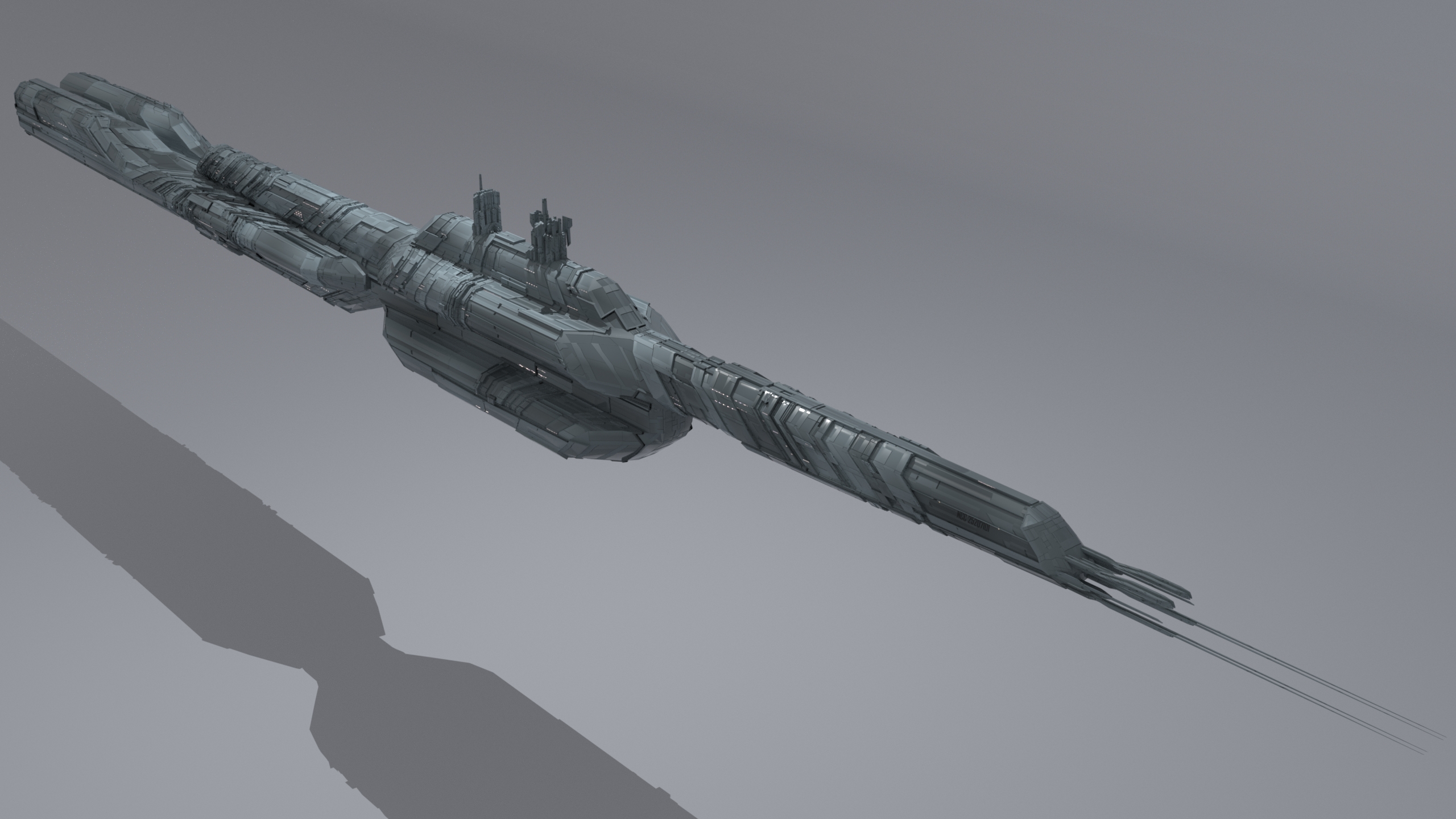

8 posts
Joined: Feb. 2020
Here's some work from today: I grouped and assigned a different whiter jsplacement material to the top and bottom faces of the geometry to get a nicer effect:
18 posts
Joined: Oct. 2017
Really nice! I think the added contrast with the white material adds a new dimension to the model. I also like the look of the voronoi-approach. Have you considered adding circular shapes to your ship so it looks more like this [i.kinja-img.com]?
