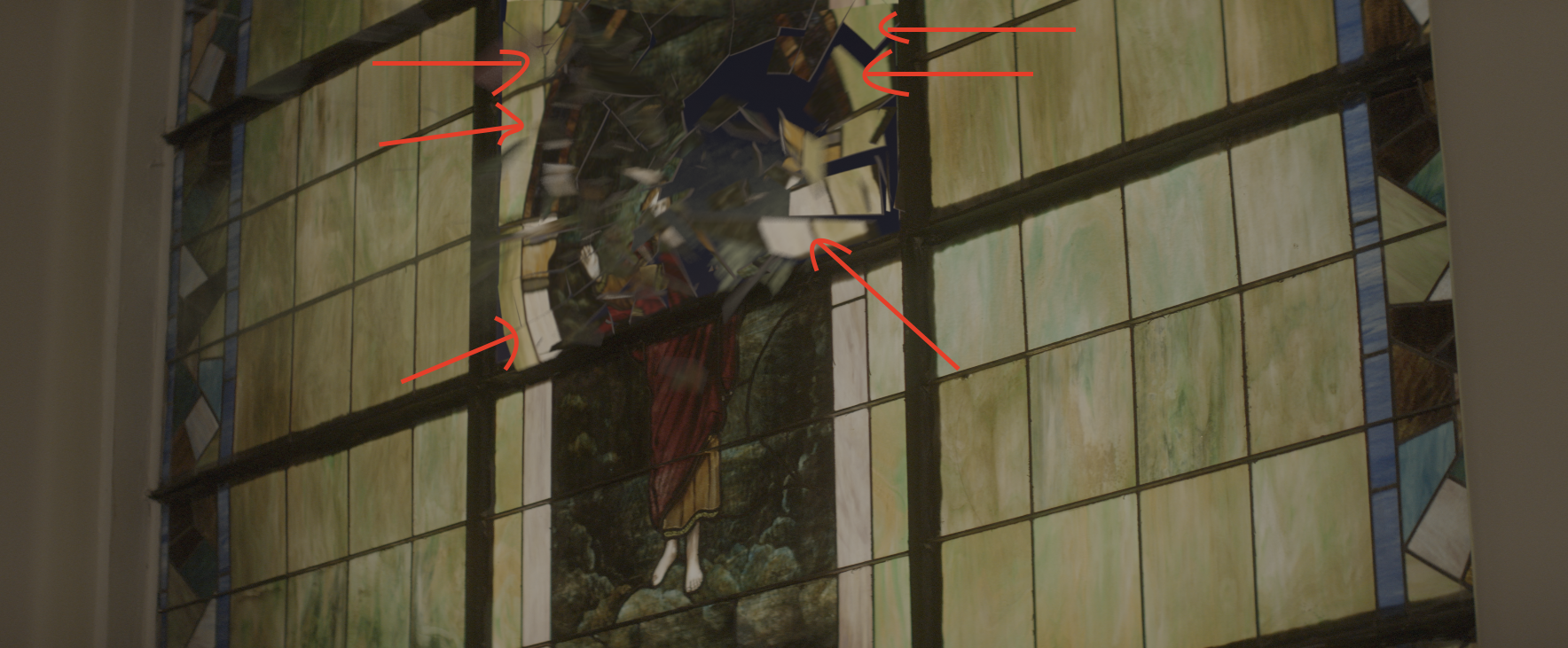

I'm trying to shatter a window using the new RBD SOP nodes. The challenge is that I would like some of the pieces to remain in place as if stuck to the window frame and I'm not having much luck accomplishing that result.
Any advice as to how to go about it?
I'm attaching a reference frame, I'd like for the pieces where the arrows are pointing to stay put and not be included in the simulation. I have built some hard constraints around the glass in the location of the window frame, but I can't figure out how to connect the specific pieces of the glass to the sides, or how to group them and exclude them.
I'm also attaching a .hip file.
Thanks!

You can use RBD Configure SOP, section “Attributes”, add pieces you want to stay still in group, use “Active” parameter on section “Bullet Data” or “Pin” parameter on section “Constraints”.

Just set i@active to zero on those pieces before the simulation. They'll act as static objects.

Yep! Just set a point attribute named active on the points representing the packed fragments you want to be static, and set the value to zero. You'll probably want to ensure that the other fragments have a value of 1. A Point Wrangle is a perfectly good way to do this, but you can use whatever nodes you like as long as you're setting that attribute as an integer.

Here is the file with two approaches using RBD Configure SOP.
1. Active. The tool sets i@active point attribute on packed primitive, as Henry said.
2. Pin. The tool sets s@name point attribute of constraint as a blank string, it means this point of constraint placed at world space position and doesn't move, a glue constraint will be unbreakable but on the other hand that constrained packed prim will not be able to collide.
You can combine these two methods of course.
I hope it helps.

Ok this helps immensely. It appears that the reason why I couldn't get RBDConfigure to work properly was because the Constraint Geo inputs and outputs were connected all the way through effectively negating the RBDConfigure attributes.
In your second example, the Constraint Geo is connected, but I guess when using the Pin function everything works regardless.
Thank you both for helping me figure this out!!!

Also note that the issue with your original file was that you had “Use Bounds” checked on the RBD Configure node but didn't actually supply any bounds (by connecting the 4th input). This has the unintuitive effect of setting the value opposite of what you'd expect (because everything is outside of the zero bounds). Perhaps what you intended to do was the following:
1. Create a box that surrounds only the glass pieces you want to shatter (presumably in the center of the window) and connect it to the 4th input.
2. Set Active to 1 and check Use Bounds - this will mark only the pieces within the box as active.
And yeah typically RBD Configure feeds directly into RBD Bullet Solver because RBD Configure conveniently packs up your geometry as well. You could stick in a prim wrangle between the pink Constraints wire if there's any further tweaks you need to make to your constraints, but this new node does simplify a lot of the constraint setup workflow.
