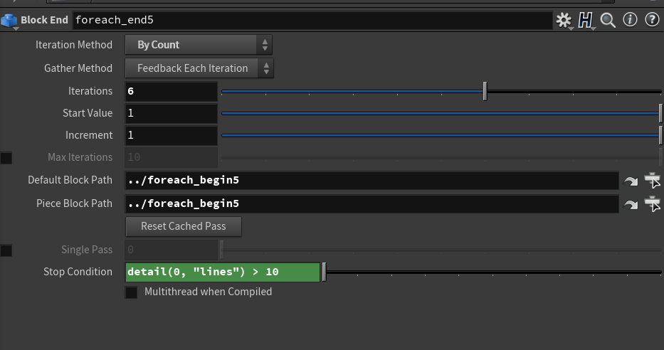

I want to setup a stop condition on For Each Loop node to work more like a "While Loop" way, (do the loop until a condition change); but I can't get to work with an attribute that dynamically updates inside the loop (as would work on VEX).

For accomplish this, I created two detail attributes that updates inside the loops but I can't get to set them as Stop Conditions for Loops

Ok, I could solve it.
Apparently, the Stop Condition only can evaluates a kind of Boolean condition, so what I did, was to create another attribute that triggers from 0 to 1 when the real condition reached; in this case an attribute "distCheck" is set to 1 when a distance threshold is reached; then every time, the loop evaluates that attribute, if its value is 1, the loop stops.
if(@distEnd <= maxDist){
@distCheck = 1;
I hope this could help someone later.
