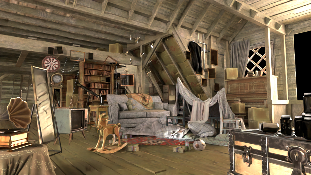

So I was creating HDAs to simplify use of the stand alone utilities when I realized that idenoise does not seem to be performing properly. The problem im having is that it doesn't read Normal and Albedo planes. I am not getting an error i have typed in the plane names correctly which for some reason has the name appended to itself out of karma like `indirectdiffuse.indirectdiffuse`. However referencing these planes does not change the image output at all. I tested this with multiple renders and got the same result. I also tested the Denoise COP and found the same thing since they both run of idenoise. I downloaded OIDN from github and ran the images there with pfm files and the result was 1000000x better. The only change i have made is i am running --exrmode 0 in husk otherwise most of the other softwares cannot read the multilayer exr. Ive attached 2 images, one is out of idenoise with both planes enabled and the other is from oidn standalone.
