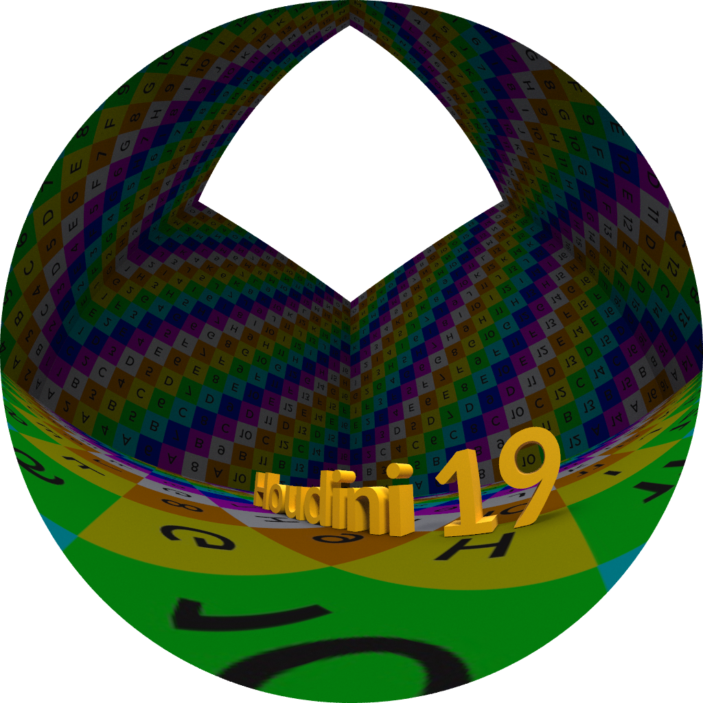

Technical Director II Matt Blackwell was able to port his beloved Mantra fisheye lens shader to a Houdini 19 Karma lens shader.
See attached example render.
It works on my Linux workstation running Houdini 19.0.531, but when I submit it to our Qube farm we get the error:
Error loading lens shader: Unable to load shader 'opdef:/Vop/fishLens?CVexVflCode'
Error loading lens shader: must have P and I as outputs.
The lens shader is defined in an HDA.
The worker nodes on the farm should be able to see the same HDA. So why can't they load the shader?
