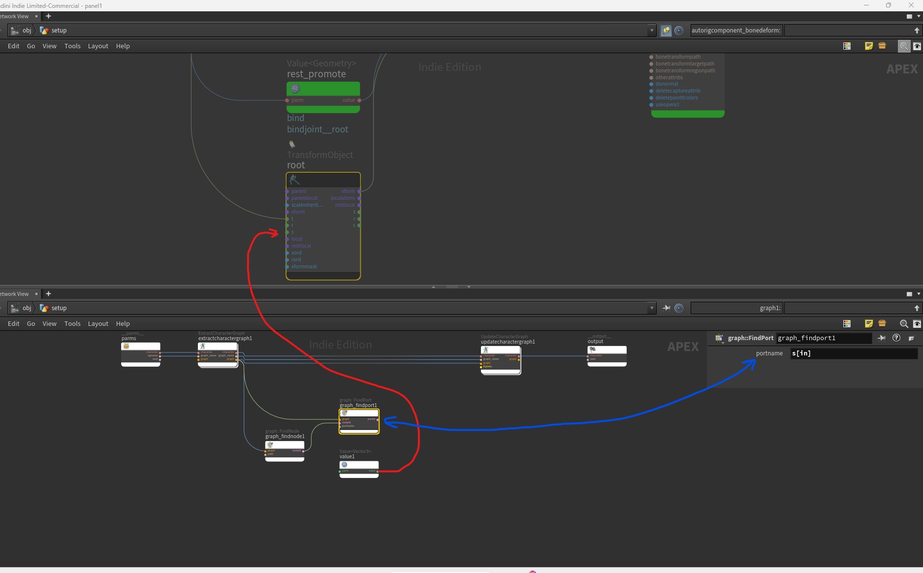

Hello,
In apex, how can I connect an output port of a node into the input port of another node in another graph? If you look at my photo, I want to connect this vector into to the scale of a transform object in another graph. I used the graph find node, then graph find port to get the portid of the input s from the transform object. What do I do next? I am lost on what to do. (or is this not possible) I included the hip file.
Thanks
Edited by evanrudefx - 2026年6月11日 12:40:21
setup.hiplc (413.7 KB)
Thanks,
Evan
287 posts
Joined: 2月 2016
A video from max rose actually helped me figure this out thanks . I just need to use the graph add node to insert a node into that other graph. Then I can use the graph connect input.
