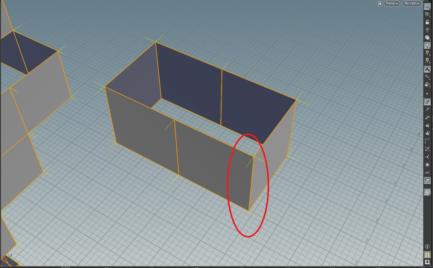

I absolutely got my answer for what I asked. Thank you for the tips guys. But I just realized I have phrased it all wrong. My bad. What I had in mind.
Can you select these polygons with one click?
You just click once on one primitive and the selection continues until it hits a certain angle treshold. In this example it could be anything from 0 up to 89.999.. I know I could do it manually and there are great valid ways to do it. But applications could get more complex, this is just to demonstrate what I am looking for.
This is the feature I am looking for.
