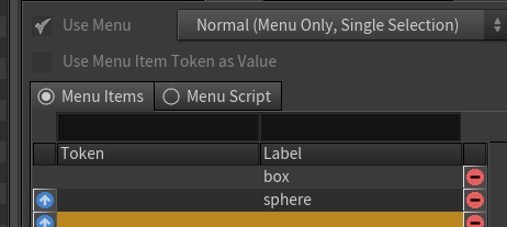

So creating a menu like this will work fine:
… any channel references to the button strip will correctly return the index of the selected item. HOWEVER, the state of the button strip will not be saved with the hip file.

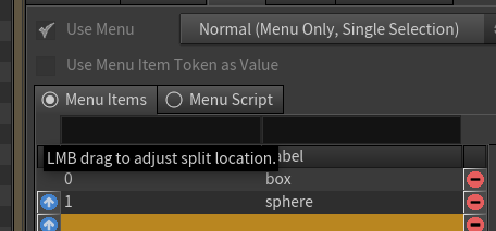

You need to add tokens, though they can be anything. I've happened to put 0 and 1 in here, but any numbers will do - the channel returns the index of the menu item, not the token (unless you enable “Use Menu Item Token as Value” above).
So this is the fix:
So this is the fix:
