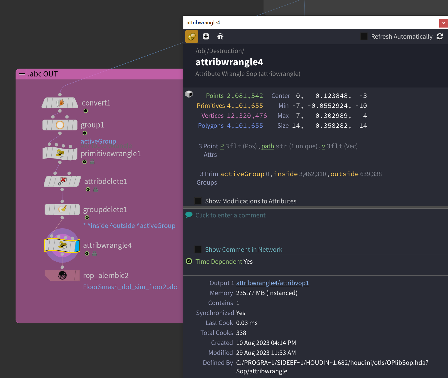

Im not sure. inside and outside faces are exported in the alembic as prim groups and come into c4d as selections. I'd like the activegroup to be the same.
My node setup is probably wrong, but this give me the activeGroup as a prim group, only nothing gets put in the group.

27 posts
Joined: 4月 2020
That works to get activeGroup as a face selection like inside/outside, but everything is in the group. Doesnt look like "v@P != v@initpos" is separating them into in/out of the group.

27 posts
Joined: 4月 2020
Thanks Hatchery.
No I didnt...and also didnt add the geo to input 2.
Looks like that works, but might be an alembic limitation now.
Houdini updates the activeGroup as the RBD runs and pieces move, but the selection in the alembic in C4D is always empty. I think maybe selections cant be animated (unless its with C4D fields).
Maybe if it would work if I can get that group as a vertex map in the alembic?
