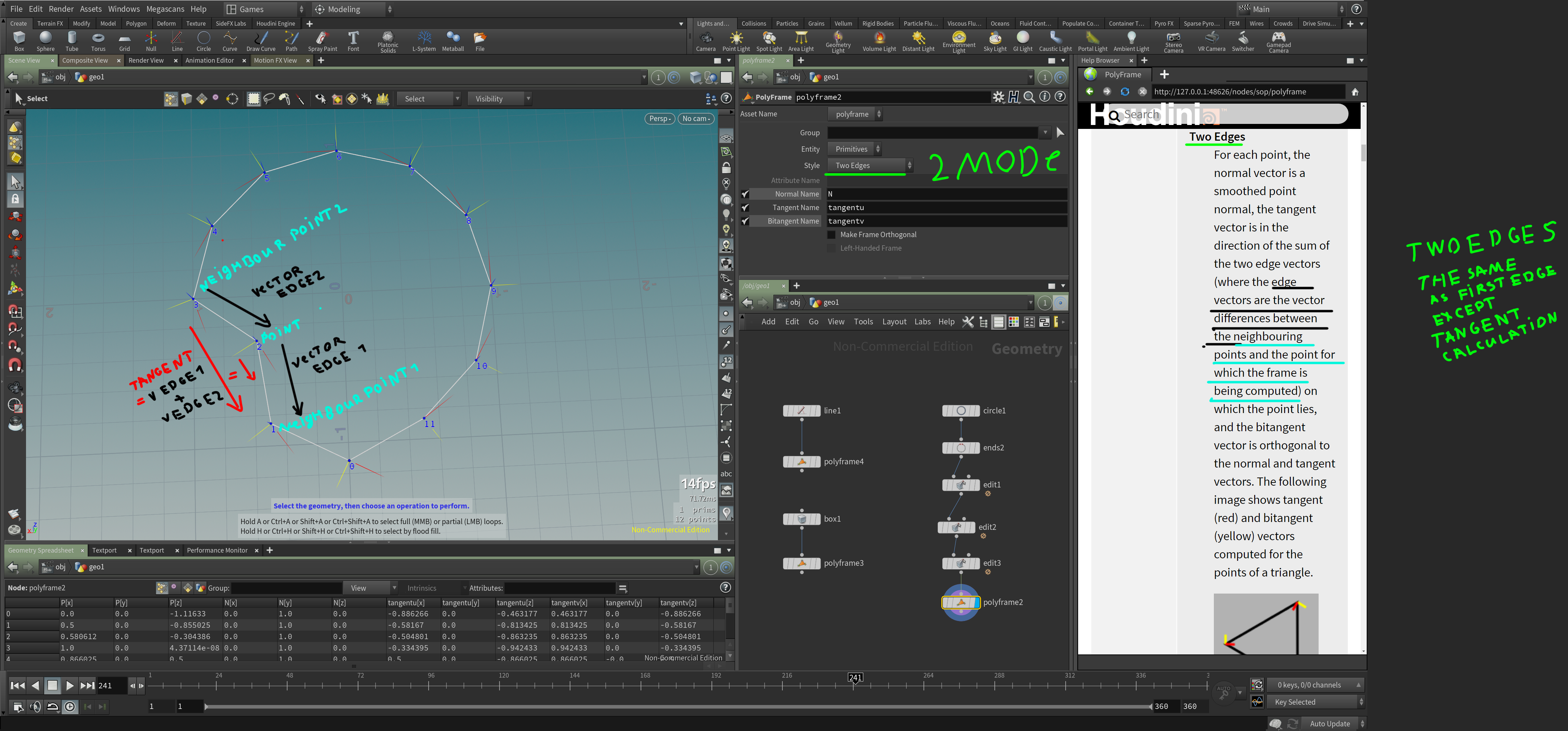

Docs describes it pretty well if you understand how vector math works. I'd recommend to watch the lesson to understand how to do basic operations and troubleshoot vectors with visualizers
First of all, Polyframe can recalculate normals. In our case(single flat poly) it's just +Y vector {0,1,0}
That's much easier to see how Polyframe works when Style parameter set to First Edge
But you need to set up second style - Two edges, to get Bitangent vector looks in the middle (that's not how it's actually calculates) of two neighbour edges.
Because you calculated Bitangent vector in right direction that makes unlikely any intersection between points, then you can add the bitangent(tangentv) vector to current point position and it will move point in direction and length of bitangent vector.
Also, you can multiply bitangent vector to any scalar value and change vector length to get interesting results for all points.
