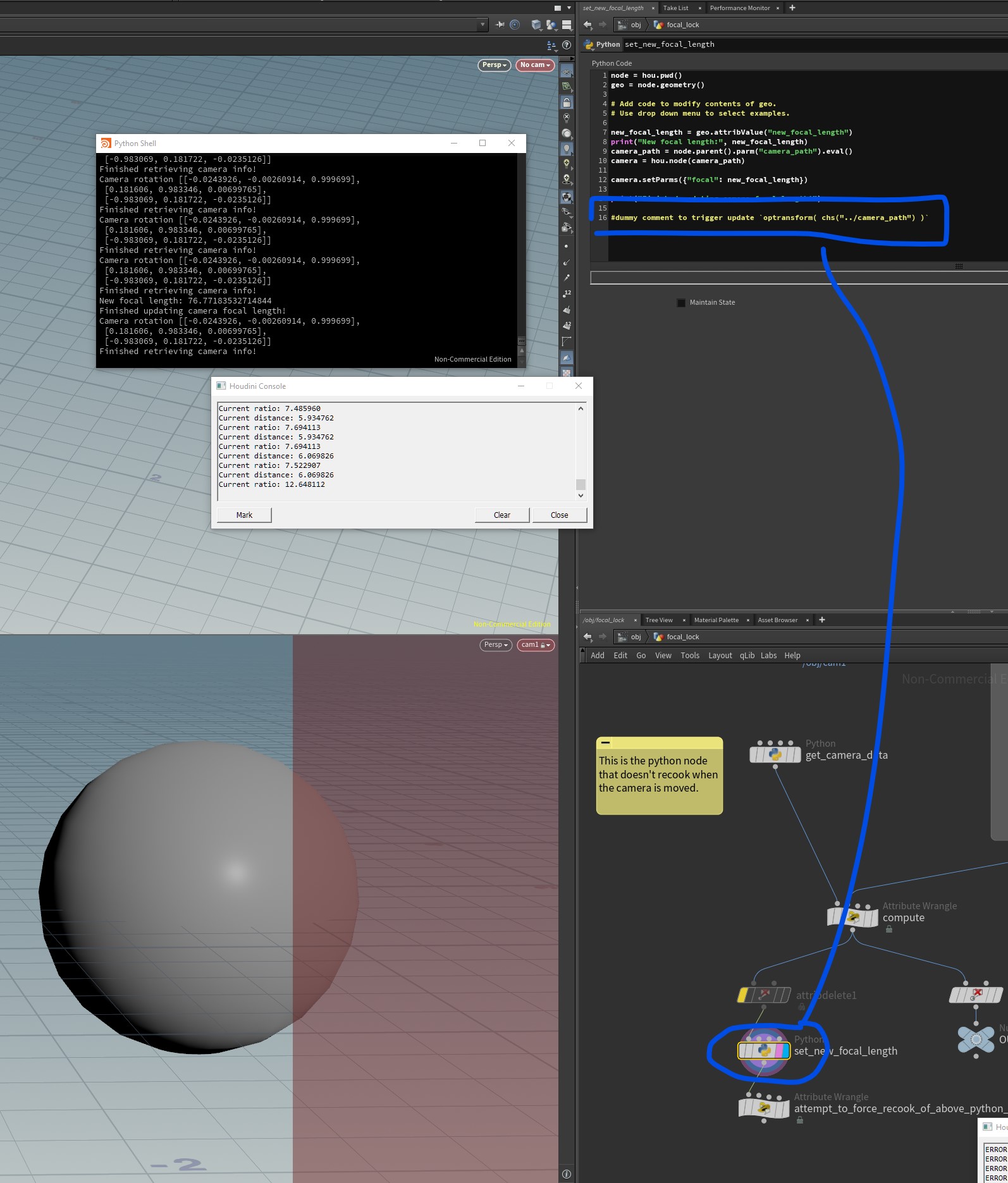

If I take the hip file you posted and add this line the the "set_new_focal_lenght" node it works fine and prints updates.
#dummy comment to trigger update `optransform( chs("../camera_path") )`
But again, this is solution is not going to win any prizes and as Graham suggest doing this though attributes is better way.

I'm experiencing two issues: if I have the camera reference the new focal length in a detail attribute, this creates infinite recursion (I guess when the detail attribute changes, the camera changes, which causes the Python node to cook again which recooks the node the computes the new focal length...)
Also, thanks for the tip on using the scene reference data! Looking at the code that makes it up it appears that it still references the entire camera SOP and would thus recook the node even if only the focal length changes. Any tips on how to avoid this?

Also, I added this line and it does exactly what I need it to do! Very interesting.

I guess the main reason this confuses me is: why does this solution (of putting a reference to the camera's path in a comment of the Python node) eliminate the issue of infinite recursion (which apparently was the reason it wasn't cooking originally)?
298 posts
Joined: 7月 2013
that's because only a transform matrix change will trigger an update (that's what we're inserting into the comment line). A focal change has no effect on that matrix and hence there is no looping issue.
