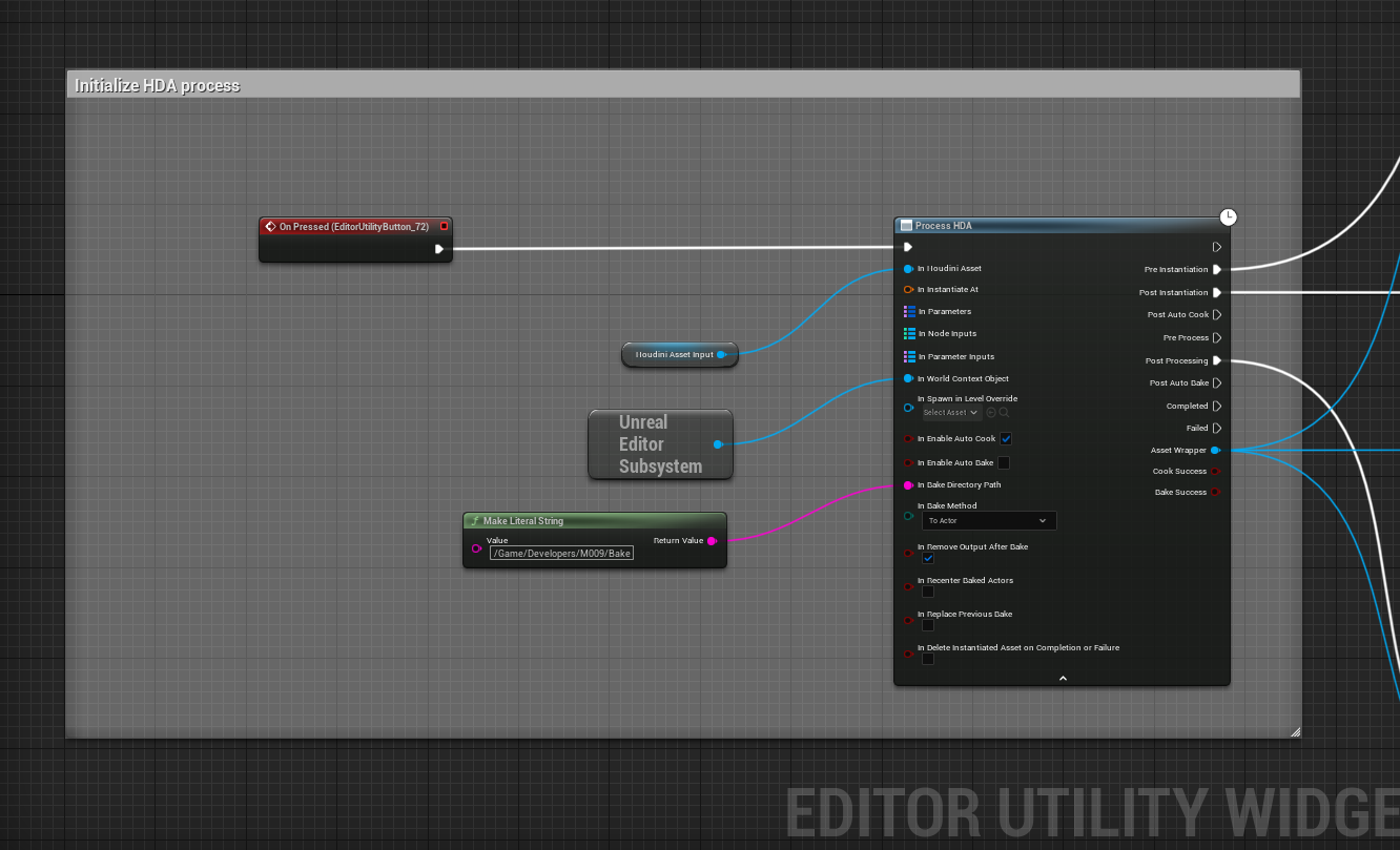

I'm try to bake Static Mesh with an instantiated HDA create in a Blueprint Utility (Asset Action Utility) . Here a simplified Blueprint (I take care to create the HE session manually before launch the script). Note that I debug with print string on each steps :
When I launch my script, the instanced HDA is create, but the bake don't work.
However, custom parameters pass in the instanced HDA (cf. my custom bake directory path).
If I manually hit the "Bake" button on this instanced HDA, bake is done in the correct directory (/game/bake).
Here my "debug" version, all my print String are in the Output logs

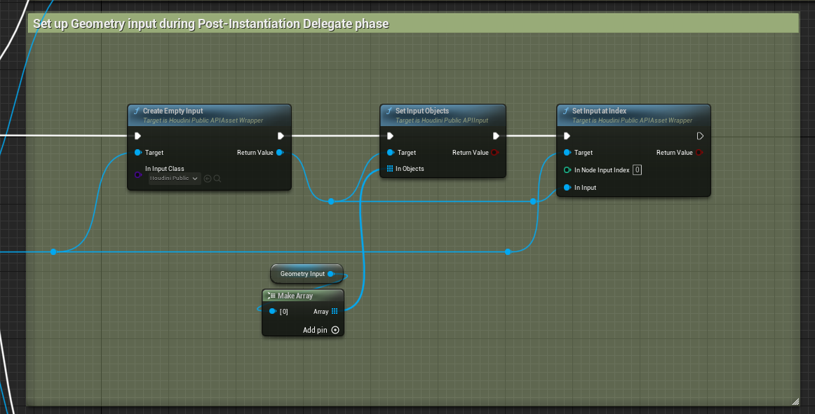

Well, I've moved on a bit.
So, it seems that despite the fact that the doc says the delegate is optional, it doesn't work without it. The Blueprint goes faster than the cook... So, nothing was executed afterwards.
I can get everything to work except the bake:

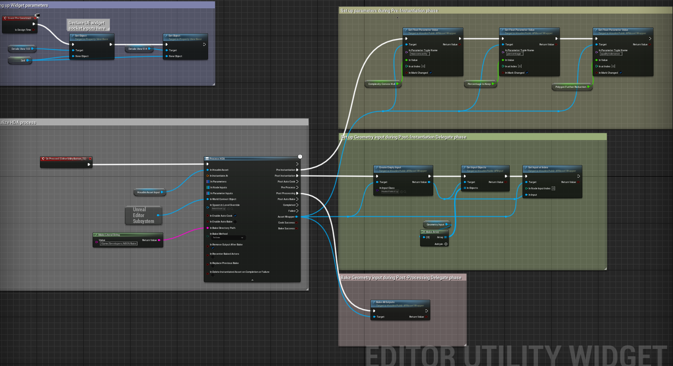

Strange thing is, "Bake All Outputs with setting" return value is "True" :
For now, I don't understand how to bake from Blueprint Utility. Keep pushing.
Vincent
Joined: 10月 2018
Finaly got it ! With the priceless help of "Seb", from Think Procedural Discord.
