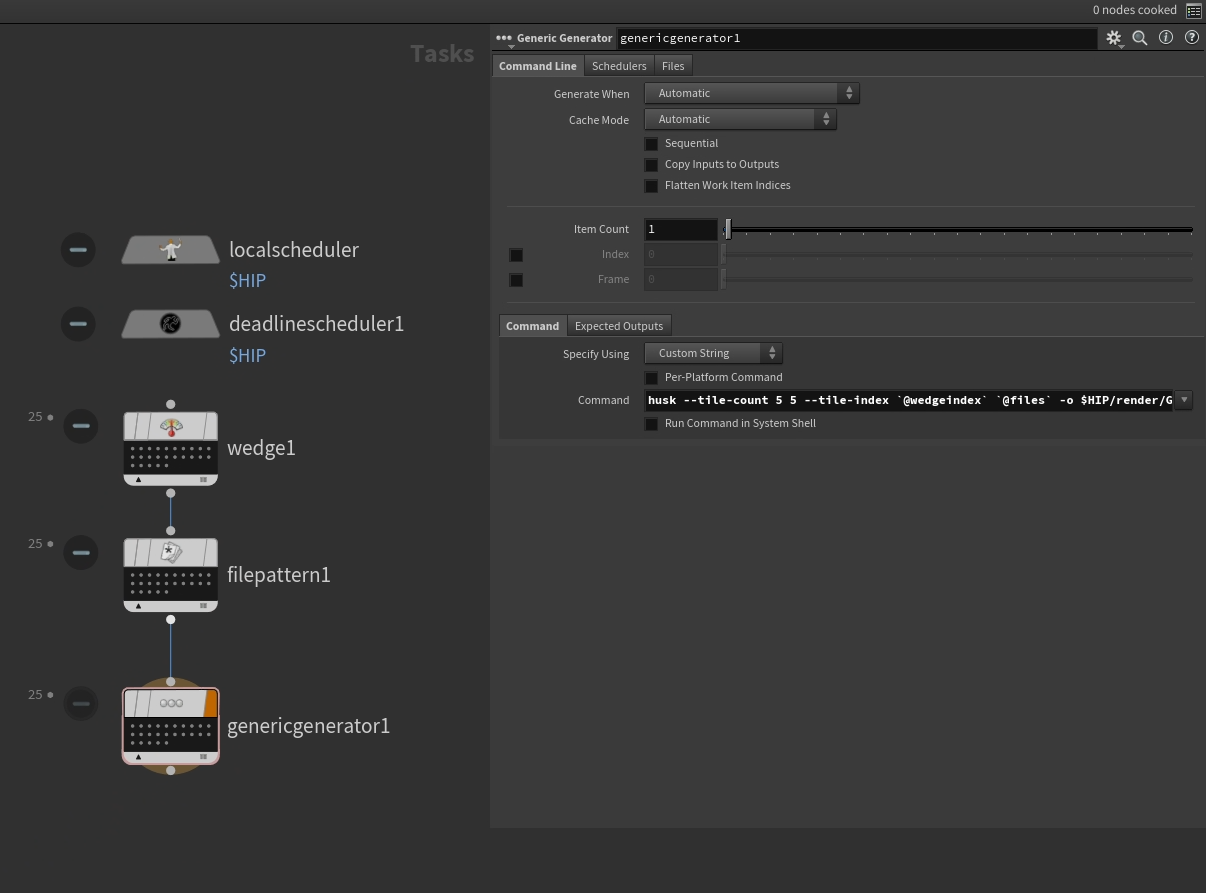

Here is the topnet, there is no ROP. It just call's husk to render a frame with 25 tiles.
Works locally.
Cant find any tabs for batching or frames.
Just want deadline to make all the work items separate frames on deadline, the whole point is to render a 4k image via husk with 2-4 render nodes.
Works locally.

How are you cooking your graph? If you're pressing the Submit button on the Deadline scheduler, that submits your entire scene file as job to the farm. If you want to cook interactively you should first set your Deadline scheduler as the default, which you can do by Right-mouse clicking on it and finding the option in the list. Then you can cook normally by using Shift+G on RMB->Cook Node on your output node.
