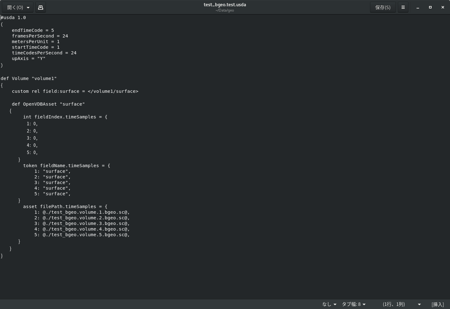

Hello,
I want to create a USD file that references a bgeo file of a mesh with topology that changes over time. This is an image of the result of using the Volume LOP to import a volume (bgeo) that animates over 5 frames and export it as a USD file.
I would like to do this with a mesh instead of a volume.
I want to create a USD file that does not directly write out position information, but instead loads sequential bgeo files for each frame.
I would appreciate it if someone could provide an answer. Thank you in advance.

Check this out
https://www.sidefx.com/forum/topic/99593/#post-436517 [www.sidefx.com]
Joined: 10月 2021
jsmack
Check this out
Thank you very much for your reply, jsmack. I have read the article you attached. After trying the method described, I was able to achieve the results I was looking for. I had spent a lot of time on this research, so your help was truly appreciated. Thank you very much
