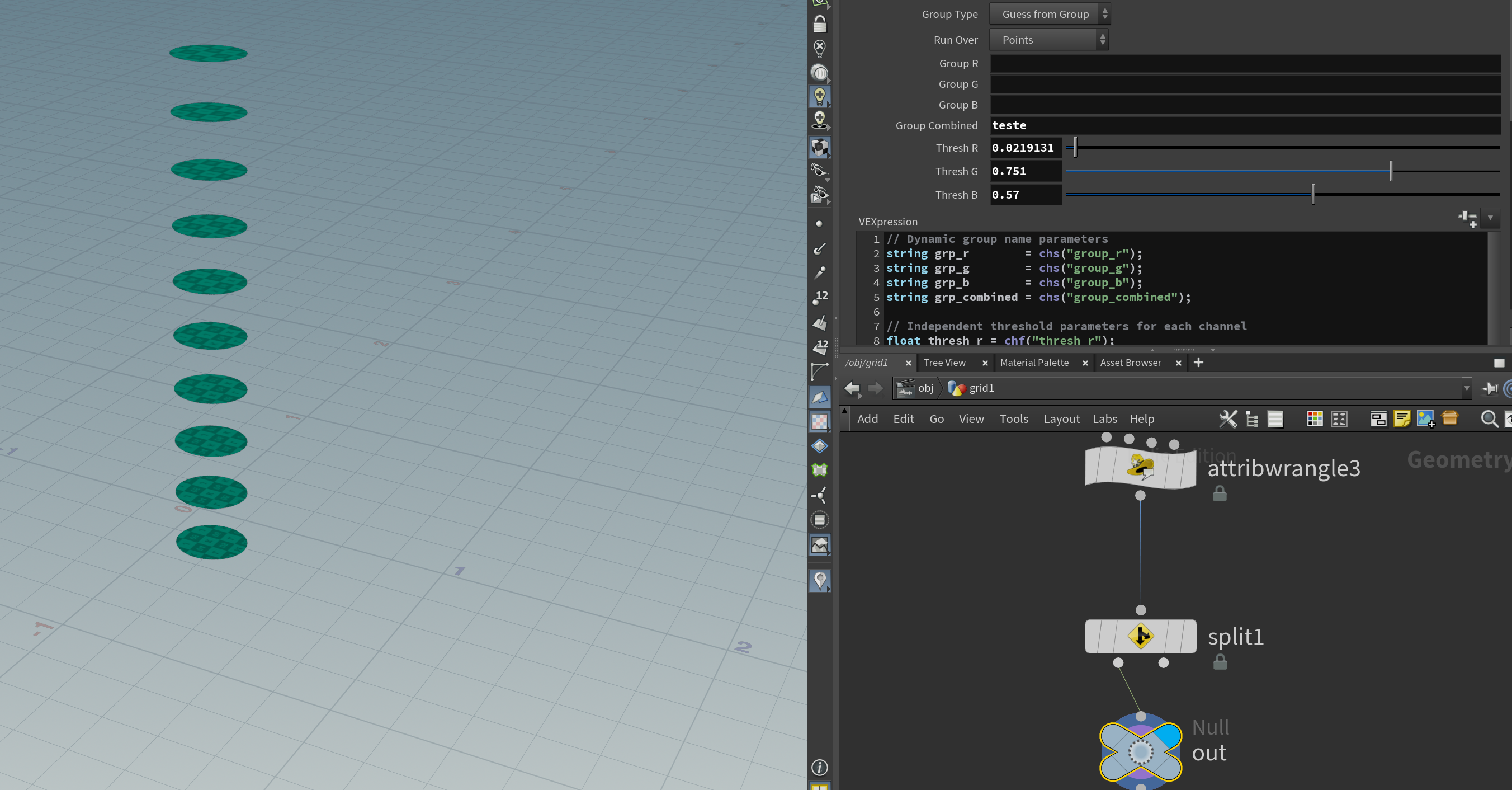

Final update , I added a attribute wrangler with slides and finally got groups by RGB values with adjustments.
Works!
Thx a lot!
