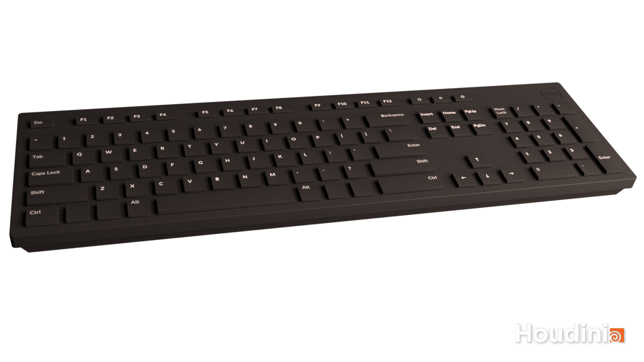

Anyways, attaching the rendered version for you to be proud of me 😁
Thanks again!
