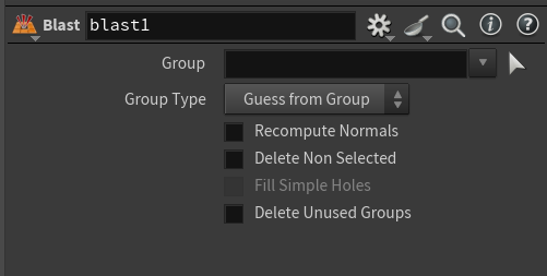

Hi folks,
Does anyone know if there is a shortcut for this button.
For example, you can select with S key a primitive in the viewport and then press tab and type blast.
But often times I create the nodes in the node network and then I need to drag the mouse to the very left of the screen to this button. Often times I select the wrong point or edge. So a hotkey would be a pretty good thing.
I coudnt find it the Hotkey Manager. Perhaps I am using the wrong keywords.
9553 posts
Joined: July 2007
not necessarily for a specific button, but there is a shortcut to do the same thing in the viewport if you press ` (left of 1)
it's in the Select menu called Reselect For Current Tool
6 posts
Joined: Sept. 2023
Thank you very much !
