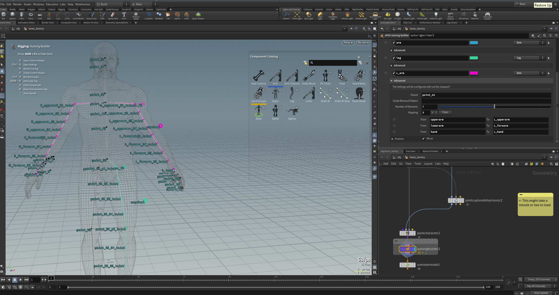

I can't get APEX Autorig Builder to Mirror the components I tag onto the skeleton. I used 'Attribute Adjust Array' to add tags to the skeleton how we did in 20.5 for L and R limbs.
I've gone through the documentation a few times for the new autorig builder and I assume my issue is how i'm setting up the skeleton but I also don't know enough rigging or the APEX graphs to figure out where I went wrong.
I added a simple version of the scene to replicate my setup.

Joints should be named properly also, not just "@name=point_##"

I thought the attribute adjust was renaming them. But it seems like you renamed the points on the Skeleton itself.
