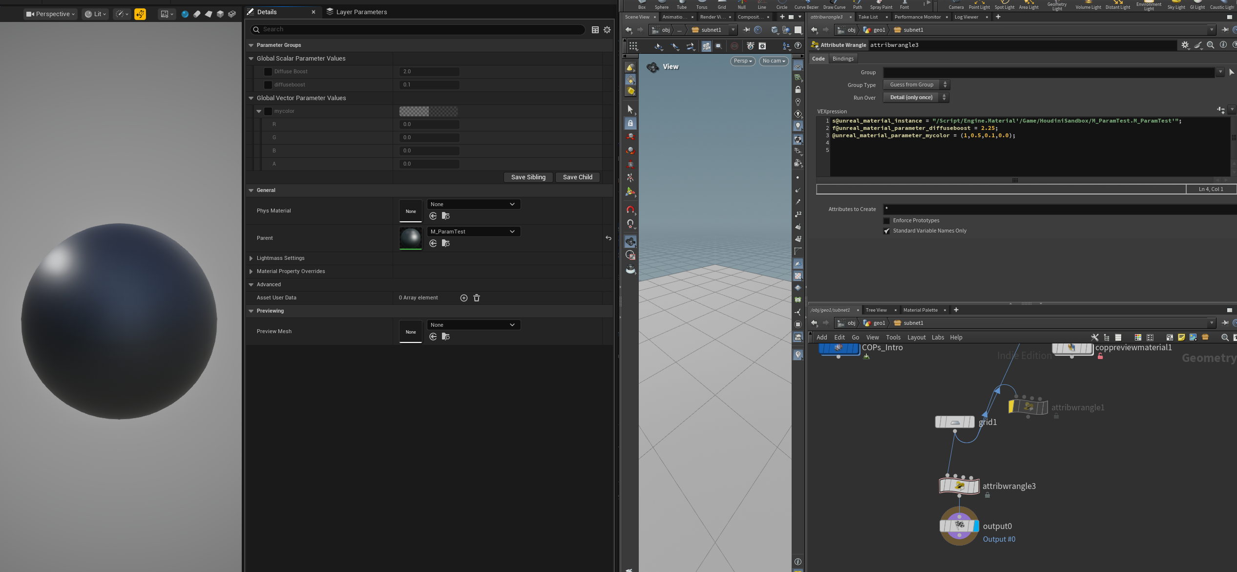

Following up with a visual example.
The material instance is created correctly and I have some parameters with my vex along side. Why doesn't this work like it's quoted in the docs?
"To change a custom My Color Vector parameter that you created in your material, add a unreal_material_parameter_mycolor detail attribute, Float with a tuple size of 4, and set its value to the desired color value, ( 1.0, 0.0, 0.0, 1.0 ) for a bright red"
