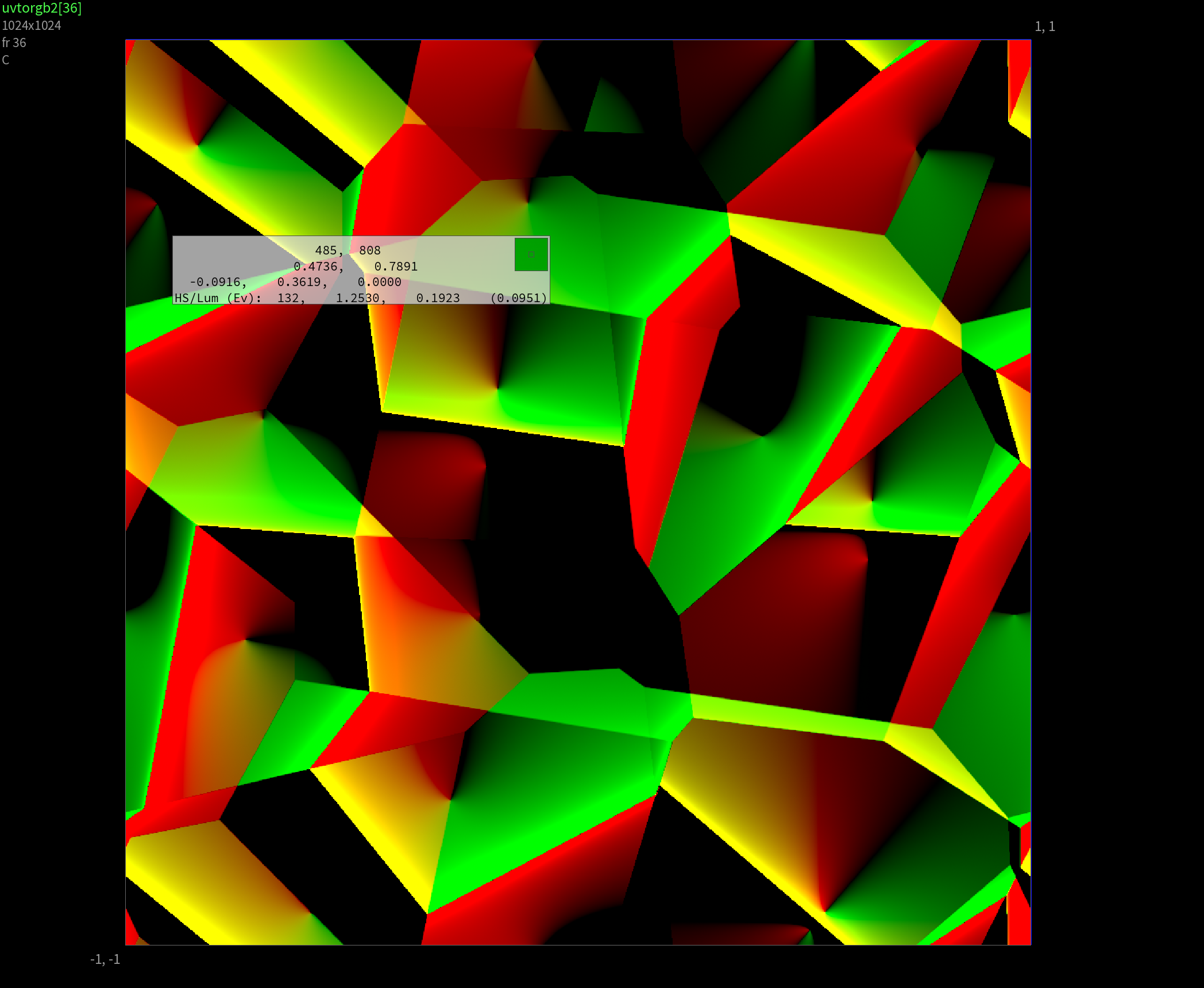

Hello I've been playing with the flow options converting noise patterns to velocity via the Slope sop.
I really like the colours as displayed in the SLOPE SOP and would like to export them as RGB.
The problem I have when doing a UV to RGB is that colours change.
Does anyone know how to conserve the colours?
I thought this was simple but I've ended up doing a deep dive on layer properties and see from inside the sope sop
that its type is 'vector' as a opposed to 'color'. And I'm guessing that its doing something to display it in RGB for us, the U and V set to R and G with some scaling but how is the B ?
Any thoughts much appreciated thanks
