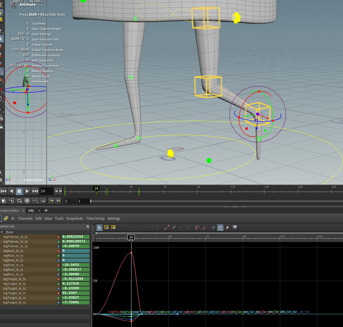

Hello!
I created a rig with the Auto Rig Builder and intend to animate my character with it. However, the FK controls have no channels attached and cannot be animated. Is there a reason for this, and how do I fix it? Thank you!
Joined: June 2021
Do you have layers by any chance, and the fk controls are not included on the layer you are animating on?
8 posts
Joined: Aug. 2024
Hey, thanks for the reply!
I did not have layers enabled. I'm not familiar enough with APEX to know if this was a user error or bug, but it fixed itself once I set up proper mirroring on the rig.
