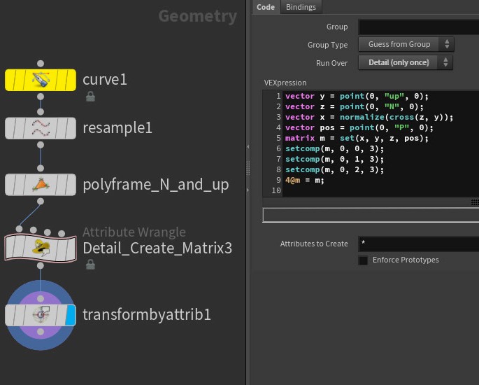

I usually use matrices to do this sort of thing. You already have 2 axis, you just need to create one more with a cross product. In a Detail Wrangle I used:
vector y = point(0, "up", 0);
vector z = point(0, "N", 0);
vector x = normalize(cross(z, y)); // getting the perpendicular vector
vector pos = point(0, "P", 0);
matrix m = set(x, y, z, pos);
setcomp(m, 0, 0, 3); // Making sur the last column has zeros
setcomp(m, 0, 1, 3); //
setcomp(m, 0, 2, 3); //
4@m = m;
...right after the wrangle, you place a "Transform_by_Attribute" sop with "m". Make sur you activate the "Invert Transform".
