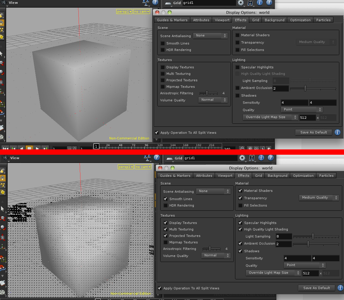

I wish this were true. I just got a mac pro 6-core westmere up and running with the default ATI 5770, osx 10.6.4 and the artifacts in houdini 11.0.497 are pretty rough. Not only do “all H11 viewport features” *not* work, but even turning them all off there are still artifacts. attached are a few images of a cube and grid. The first pic is all viewport options off, the other is with shadows, AO and high quality shading turned on. I'd happily use a fire pro card, but that's simply not an option with an apple. Thoughts?

You need at least H11.0.480 to workaround the ATI driver bug introduced with the new Graphics Driver Update (Aug 19). For some reason, some textures that were generated by rendering to framebuffer objects would contain garbage unless they were first read back to system memory via a glGetTexImage() call. This affected the depth buffer texture primarily, which is why most effects stopped working along with the displayed garbage.
