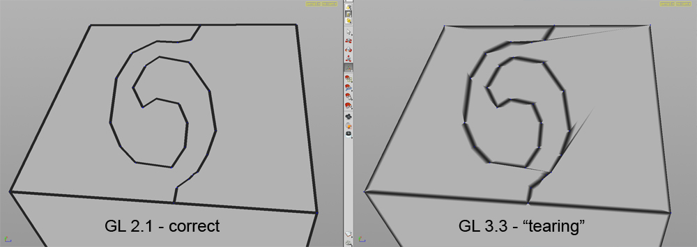

I'm still having a lot of issues with the viewport in H13, both in the office and at my setup at home (two entirely different video cards, etc), despite a recent video card upgrade. Home: GeForce 780ti, office: Quadro 4000, both drivers are recent.
“Hidden Line Invisible” in GL 3.3 produces weird n-gon tearing artifacts, see below.
This is how I'd expect it to look (GL 1.1 and GL 2.1), see below.
“Flat Wire Shaded” shades every polygon differently (new behaviour) in GL 1.1 and GL 2.1, see below.
…yet produces a slightly better result in GL 3.3, but still with the “tearing”, see below.

My guess, at least with the GL3 hidden line, is that there is either a multiple point/vertex at the spot where the tears are. The outliner attempts to compensate for these cases, but after convexing the geometry it is sometimes difficult to conclusively determine if the edge is an interior edge or not. If you turn on Disp Opts > Markers > Coincident point detection, you can see if any coincident points exist in yor model.
As a comparison, the hidden line geometry displays fine in earlier versions of houdini, and like I had mentioned above, also fine in GL 1.1 and GL 2.1 in H13. That said, those other H13 renderers have their own peculiarities as well (see above, the flat shaded example).

See below, another example of the hidden line “tearing” that I was mentioning earlier - I've emphasized the problem by turning wireframe width up to 10, but you can see what I'm talking about - GL3.3 struggles with n-gons in a way that pre-GL3.3 renderers didn't. Otherwise, it's a simple box SOP with a polysplit SOP.

Update: the “tearing” problem is apparent in any of the display modes that attempt to display edges in conjunction with solid polys (flat wire shaded, smooth wire shaded, hidden line invisible, hidden line ghost). It comes down to the new rendering scheme - it looks like each poly receives a “texture map” now that defines the boundaries with a ramp that creates the illusion of the edges, unintentionally illustrating the behind-the-scenes triangulation in the process in the case of an n-gon.

Turns out that these artifacts are occurring on edges on badly tesselated triangles, where the angle between an edge and a non-edge approaches 180°. The distance from the fragment to the edge line is less than the wire width for a portion of the non-edge, as the two are nearly parallel. This causes the bad shading.
