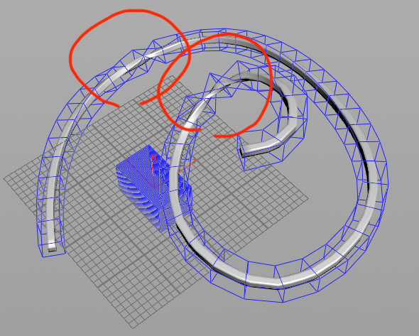

hi every one!
I just made a pathdeformer base on lattice.
it's use copysop to align grid alone the path and transfer point position to lattice gizmo to deform it.
almost is fine but in the red area you can see there has some problem.
I'm thank you if someone know how to solver this problem : )
EDIT:
this problem not happen every time.it always happen when curve is a beautiful spiral…
igou_pathdeformer.hip (115.8 KB)

Just you should use UP Vector ! :wink:
JK_igou_pathdeformer.hip (127.6 KB)

thank you Joker! yes, it is what I want
