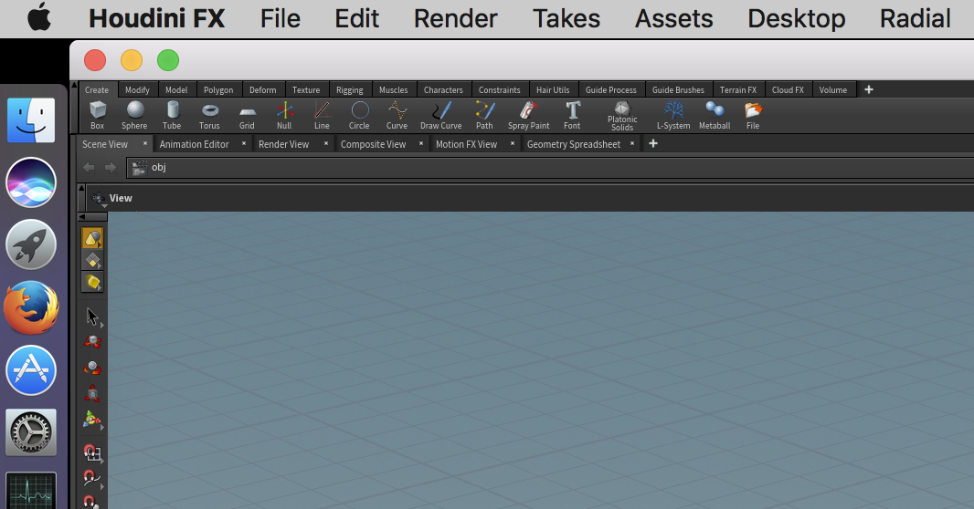

I'm using an iMac21inch (2048x1152) and a Dell 27inch monitor (2560x1440).
The interface of the latest Houdini v16.0.611 as displayed on the iMac screen has a high resolution and very small icons as shown below.
If the interface is dragged to the Dell monitor, its height is unable to be adjusted, strangely.
Plus, the preference window as shown in the Dell monitor has its contents scaled up and part of the options and buttons are not visible, and again, the size the preference window is not adjustable.
May I know if there is an option to set Houdini to adjust the resolution of its interface according to that of the native monitor?

Screen Shot 2017-05-18 at 6.04.30 PM.png (374.5 KB)
Screen Shot 2017-05-18 at 6.10.59 PM.png (32.9 KB)

If the Global UI Size is changed to “High DPI”, the Houdini interface can be changed to fit the entire screen on the Dell 27inch monitor, but the icons are scaled up too much.
Screen Shot 2017-05-18 at 6.29.05 PM.png (118.7 KB)

Yes - there are some very crazy issues on MacOs depending on the monitor setup. A 4K monitor set to a lower resolution will have tiny icons, which you need to set ‘Open in Low Resolution’ in Finder's Info window.
Oh, also set that for MPlay!
