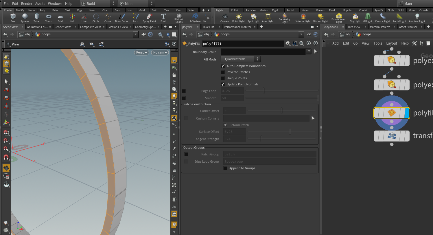

PolyFill did what I was expecting. What did it do incorrectly for you?
6 posts
Joined: March 2016
jsmack
that is odd because this is the result I get.
I have Houdini 16.5
