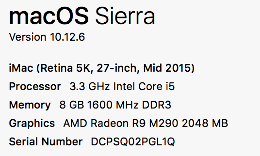

Hi, I am a 3D artist and I am getting into VFX (mostly sims like fire, fluid, sand, explosions, etc). The problem is, I currently have an iMac late 2015 model with the lowest specs: . I understand that sidefx.com says that I need at least 8 RAM but that 64 is recommended. I bought this one course about doing fluid sims, fire etc, and I can't even cache a pretty low res simulation or fire because it keeps freezing up my computer after about the 60th frame (I can't hardly do anything during the caching either). Do I need more RAM, faster processor, or a better GPU or a combination of them all? Also, I do a lot of rendering in Blender and that is pretty slow too. So, does anyone know what would be the best move for me (buying an iMac with more RAM, a Mac Pro, or what). All help is greatly appreciated!

Yeah, that i5 isn't doing you many favors. 8Gb as Twod suggested is fine for word processing, but hardly sufficient for high end computing such as fluid simulations.
