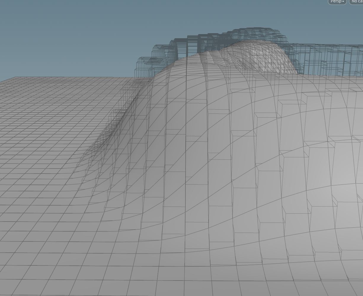

I've made an example code, but it's not very efficient because it's doing the same loop operation for each point.
Ideally you should do the averaging calculation (which is a foorloop) only once for each group of points with the same ID (some grouping trick might help in this regard).
Also, as you can see in the picture, the averaged result seems to be lower than it should be for the tallest prims. I don't know why this happens.
I attached the project file as well
int ids[] = findattribval(0, "point", "id", i@id); float avg = 0; // average position foreach(int i; ids) { vector pos = point(0, "P", i); avg += pos.y; } avg /= len(ids); @P.y = avg;
I understand now why this happens.
To fix it, just uncheck “output side” in the polyextrude.
The averaging calculation was taking in accounts also the bottom points of the side group.
But you don't actually need them.
