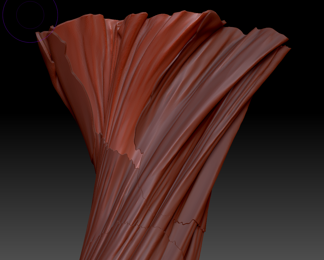

Joined: Aug. 2015
Not quite.. here is a visual.
You can see the full model in the first image and then the ‘paneling’. Did this manually in zbrush wondering if something like this can be done procedural in Houdini

738 posts
Joined: Dec. 2006
Have you tried the solid fracture and/or edge fracture SOP? They do pretty much exactly what your second image shows.
