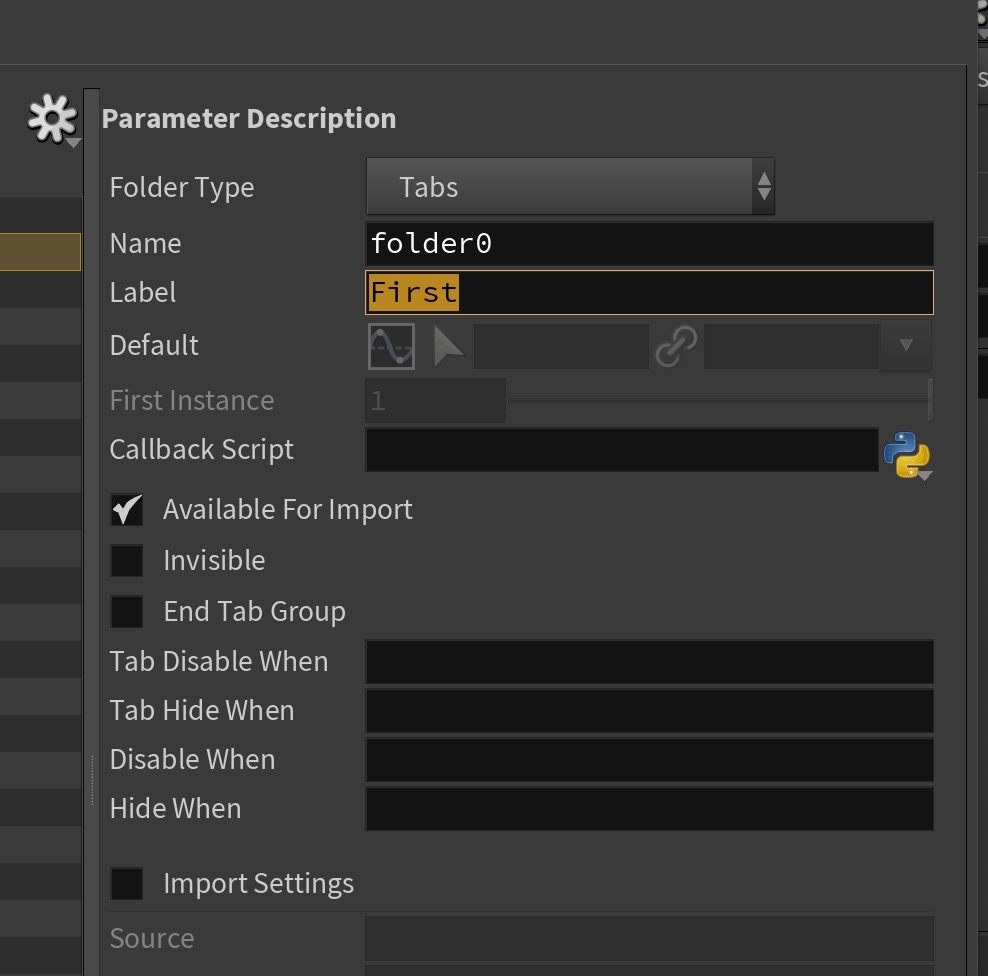

Calling from/on a hda is not going to make a difference as long as you are calling on the correct `Node`.
A couple of things to check if you are calling it on a non-nested folder you need to make it clear it is a tuple with a trailing `,`; use node.parmTuplesInFolder(('Poles', ))not node.parmTuplesInFolder(('Poles')).
Second thing to check is that you are using the folder's ‘label’ and not it's ‘name’; I know the error says name but for me it sees to require the ‘label’.
In the below you would use ‘First’ not ‘folder0’.

Screenshot 2020-07-12 at 10.33.12.png (107.0 KB)
