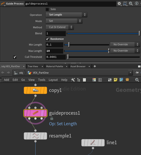

If you think of your lines as hair, you can use one of the groom nodes to randomly set the length of each line. This will give you a different travel time for each carve.
Try using the GuideProcess (set length) node.
