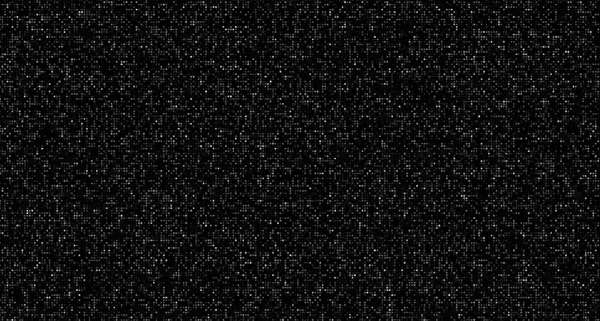

Hi CYTE, thanks for response, yeah in video is so much effects, my mistake that I didnt give more detailed information.
I post pictures for better understand what i mean. In my opinion it is the same setup for each other.
In last picture it's another style what i like. We can see nodes, but they are small. And i cant see what nodes he used.

Hey akkanein,
as a starting point for the first three Images you posted:
take a grid set it to points.
use an attribute noise or attribute random to assign a Cd value to the points.
Cheers
