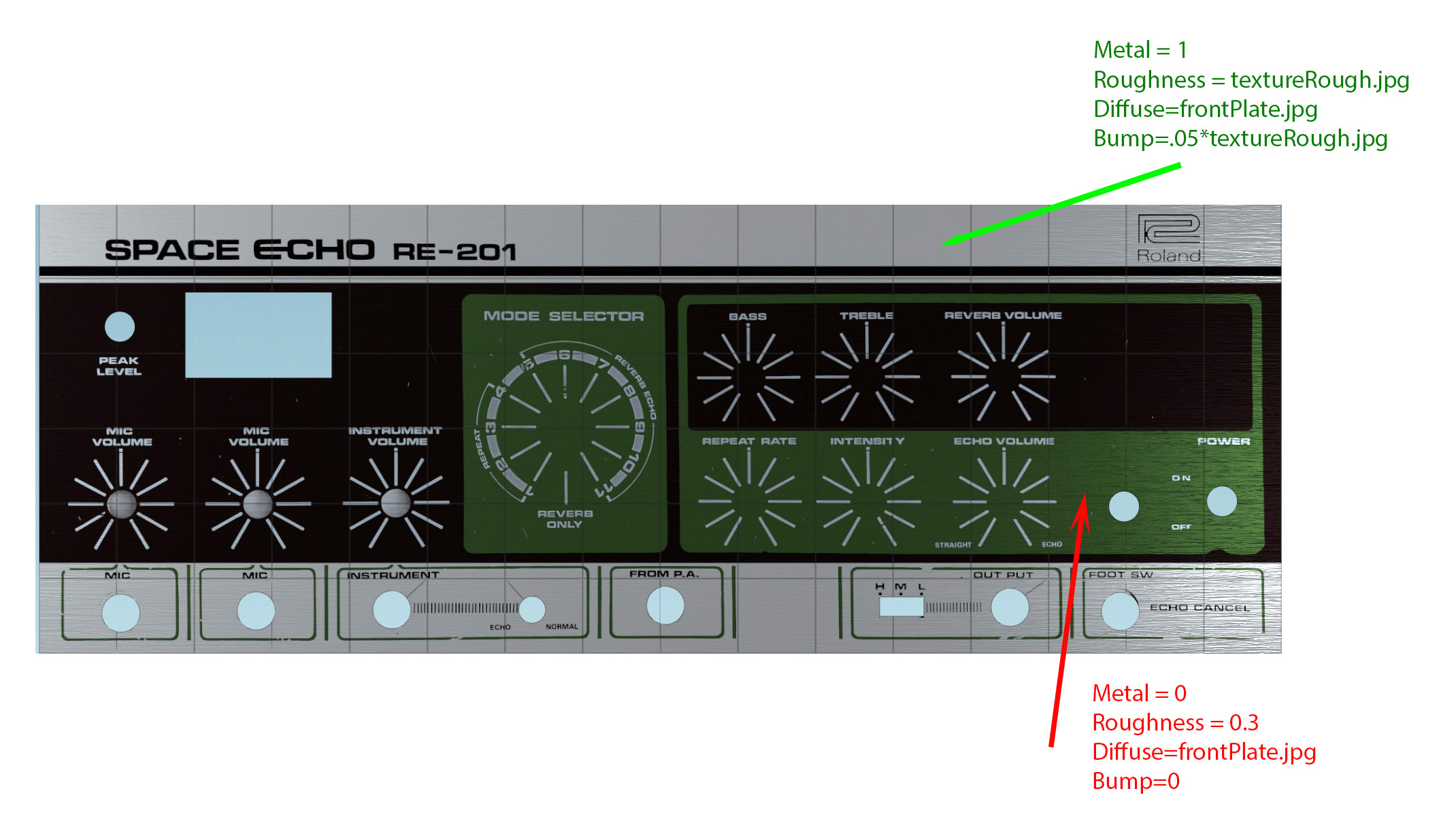

I am unclear about how to best do complex shading and materials in Houdini.
Sometimes shading and materials can be assigned to polygon groups, but there are situations where the shader and textures have to cross polygons. Of course one can add loop cuts or clip nodes and try to create polygons that match the textures, but that is sometimes not a good solution. I am not sure the best method for handing this. In Modo, it is simple, since shading and texturing is layer based, unlike any other 3D or rendering program (excepting 3Dcoat) that I know of.
The methods I am aware of for Houdini are:
1. Creating a series of textures in Photoshop for each channel (diffuse, metallic, roughness, etc.) using Photoshop's layers, modes, masks, and opacities. This works if the surface is flat, but doesn't work for normal maps or when one one wants to mask based on curvature or normals.
2. Exporting a FBX from Houdini with generic principled shaders and creating the various textures in Mari or Substance painter, where there is better visualization of the effect on the model and the ability to create masks based on curvature or normal direction. Back in Houdini, load these textures in the appropriate channels. This is what I've generally done. It is pretty easy, but one can't visualize directly the look in the rendering engine used in Houdini when working in Mari or Substance.
3. Try to set up nodes directly in the material network of Houdini based on the rendering engine used (Mantra, Arnold, Redshift, 3Delight, Octane, etc) and attempt to simulate layer modes with multiplications, additions, etc of nodes in Houdini. This has the advantage of allowing adjustment directly in Houdini, but gets really complex if one is using masks, layer modes, different opacities, etc. See second attachment for what I mean.
4. Dive into the principled shader itself (as Varomix did to add a bind based on an attribute for compositing after render). This is really complicated with all the nodes.
5. Trying to use a material builder or layer shader. I don't know when these are helpful, so I haven't used these.
An example what I am trying to do issomething like this (grey lines are polygon borders):
Complex Shaders and Textures
