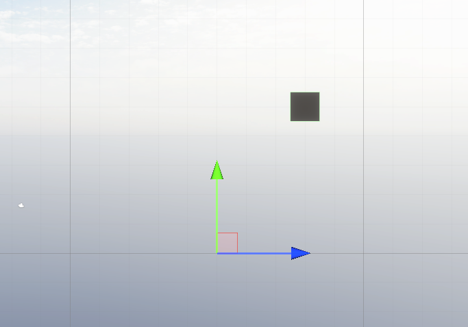

When I check "Keep world Transform", this results became as shown below.
This time, I updated the HDA. The input is gray box. The Output is red box. And gray and red squares are these origins.
The square objects are not in input game object.
Case 1. (two children)
Case 2. (one child)
This is not that I expect neither.
The difference between Case 1 and Case 2 is these origins and offsets.
Case 1 keeps children's offset.
But Case 2 doesn't child's offset.
