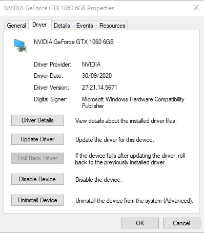

I'm on an NVidia GeForce GTX 1060 6gb. My drivers are up to date (27.21.14.5671), which doesn't sync with 465.85.

(27.21.14.5671),
That's not the right version number. What's the version displayed in Geforce experience or the Nvidia Control Panel? On linux run nvdia-smi

I'm on Windows. I normally look at the drivers from the device manager > properties. If I try updating the driver it says I'm up to date.
I did, however, find a 'system information' link from the NVidia control panel. That's telling me version 456.71. So clearly not high enough. I've manually downloaded a 512.15 studio driver. Fingers crossed that'll sort it.
