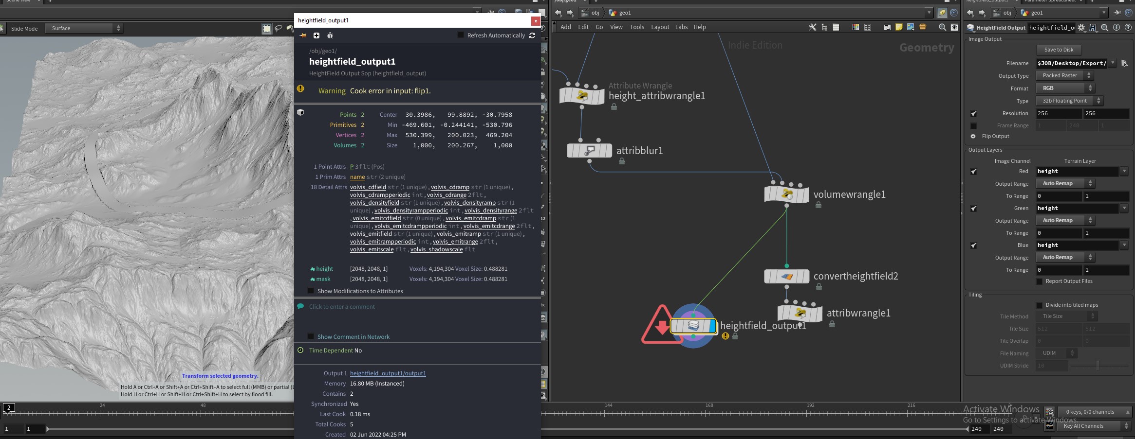

Why I'm getting this error while exporting the heightfield any idea?
# "Warning Cook error in input: window1. "

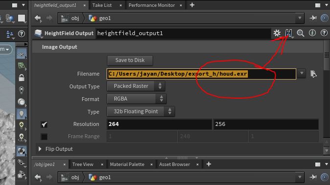

you should manually enter the file format that's it in my case, I wanted #exr format so I added #.exr but if you want Png you could .Png file format have a nice day
