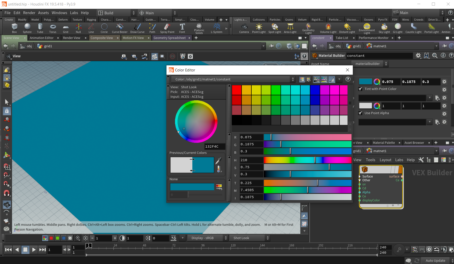

And when you pick a color from color pannel,you also want the viewport color is the same color.
There are settings on the color picker for what display view is applied to the swatch. Make sure the same view is applied in the color picker as the viewport. They look like they match to me. Note that applying a color to geometry without a material will result in a darker color, because the default material has a gray diffuse value, which is multiplied by the geometry color. In my screenshot I'm picking the color on a constant shader.
