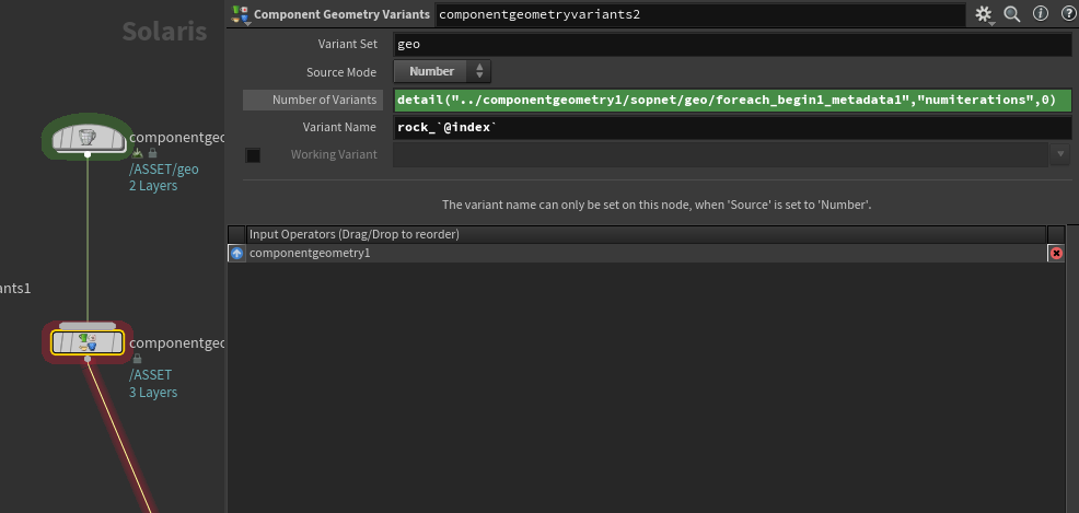

I found a solution to this problem by referring to the following forum.
https://www.sidefx.com/forum/topic/85646/ [www.sidefx.com]
Briefly, set the foreach SOP to Single Pass and set @GEOVARIANTINDEX expression.
Next, create as many Variants as numiterations in the Component Geometry Variants LOP.
Amazingly, the Component Geometry Variants LOP seems to take us into a big invisible loop.
