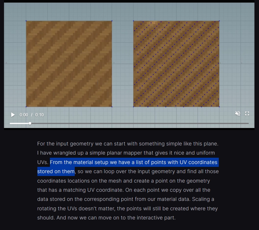

I have also stumbled upon this breakdown on Artstation - UV Based Material Fracturing - which seems to be working similarly but description is a bit vague for my skill level
Well I understand most of the stuff there but this sentence I don't: "From the material setup we have a list of points with UV coordinates stored on them" - how to do that as this should help me a lot...
