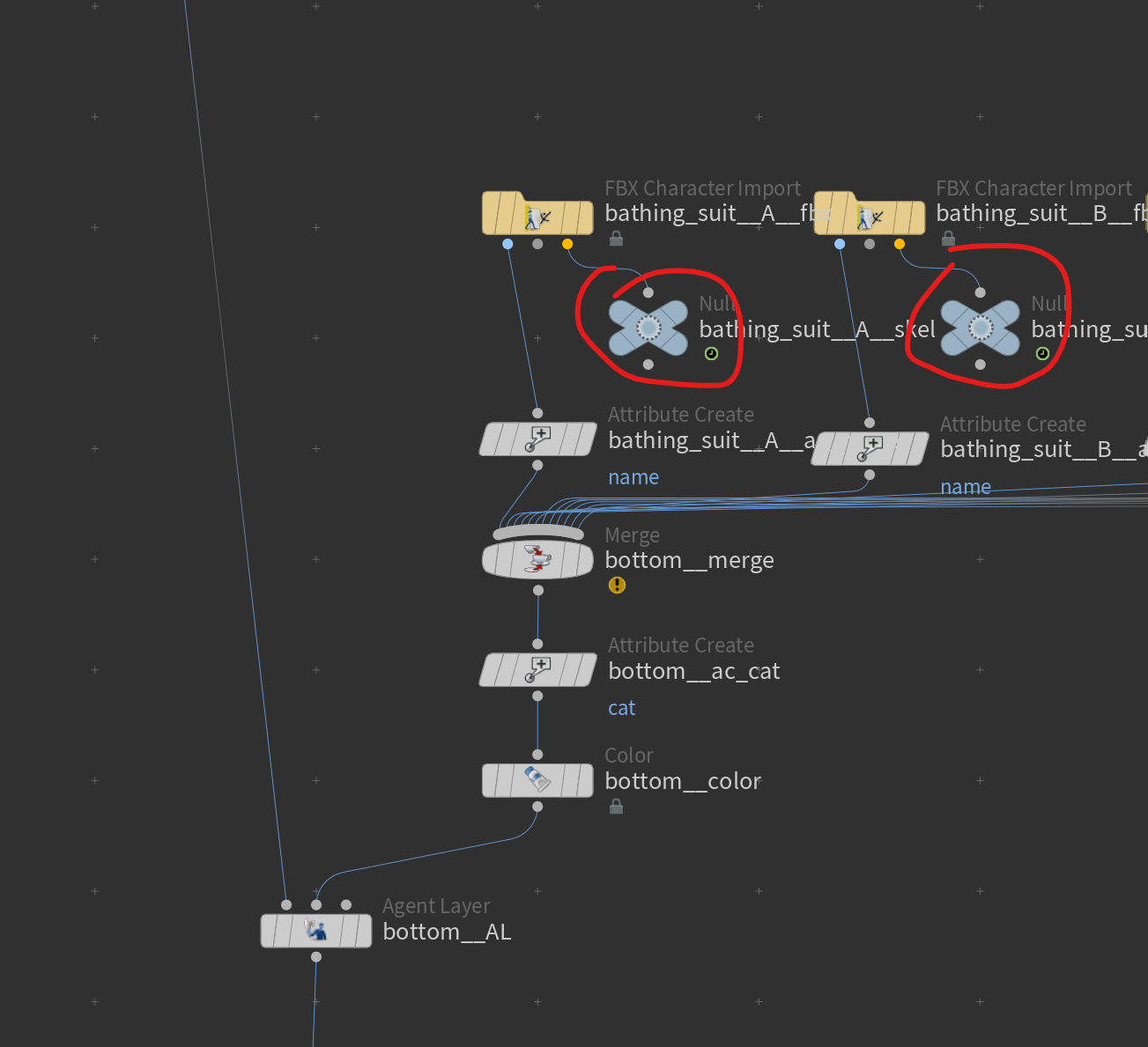

Thanks mate,
I figured it out.
It was a matter of a few steps:
1. Expand the dictionary of the "clipchannels" detail attribute with the values from the same attributes coming from imported garments (FBX nodes).
2. Filter out the blends to leave only the garments used with each particular agent (VEX code attached).
The result is lovely
