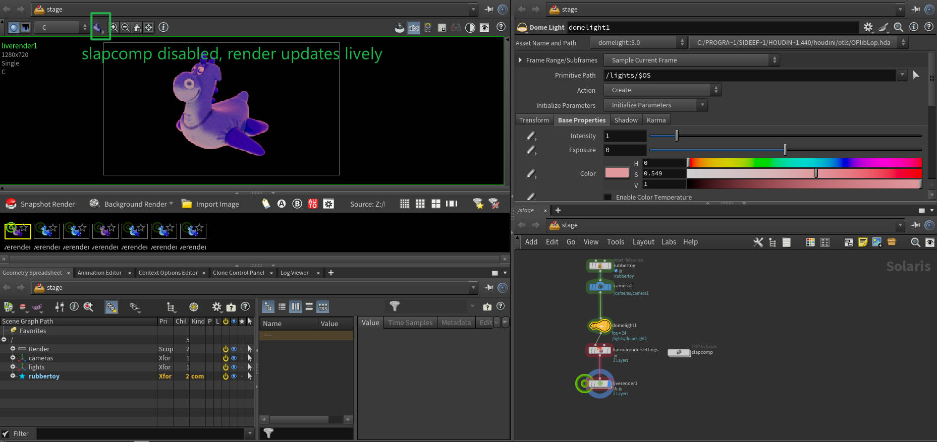

When live render to render gallery with the slapcomp enabled, is there a way to see the update lively?
In this simple setup with a white dome light, when slapcomp is enabled, I don't see the render updating live while changing the dome lighting color.
When slapcomp is disabled in Render Gallery, the render updates lively as dome light color changing.
Simple slapcomp setup with Live Recook enabled.
I am expecting the rubber toy to update lively as upstream lighting changes against the background plate configured in the COP slapcomp.

essentially what one can achieve in Scene View with Karma CPU and slapcomp enabled, I'd like to achieve it through the Live Render node in Render Galleary.
Like a live slapcomp with the CG lighting updating, in Render Gallery. Is it possible? This way I have the Scene View still in Houdini VK.
