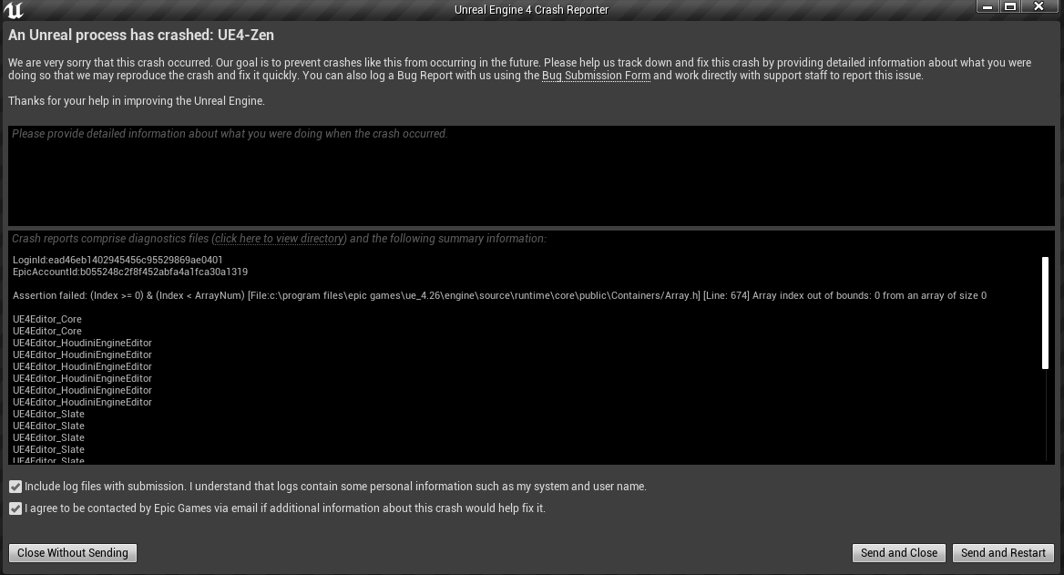

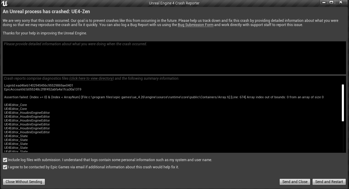

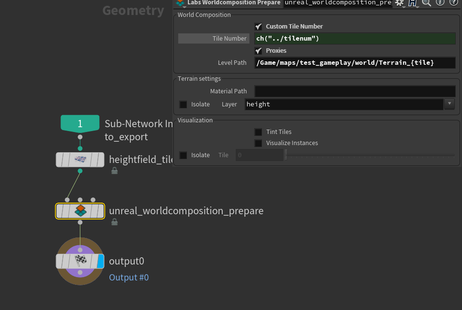

After upgrading UnrealEngint to 4.26 gaps between tiles disappeared but now Editor crashes when trying to bake PDG output.
World composition is enabled in world settings.
Pdg network:
Geometry spreadsheet for one of the items:
Content browser:
World composition node:
Outliner
Bake:
And crash:
Any suggestions?
Pdg network:
Content browser:
Outliner
Bake:
And crash:
Any suggestions?
