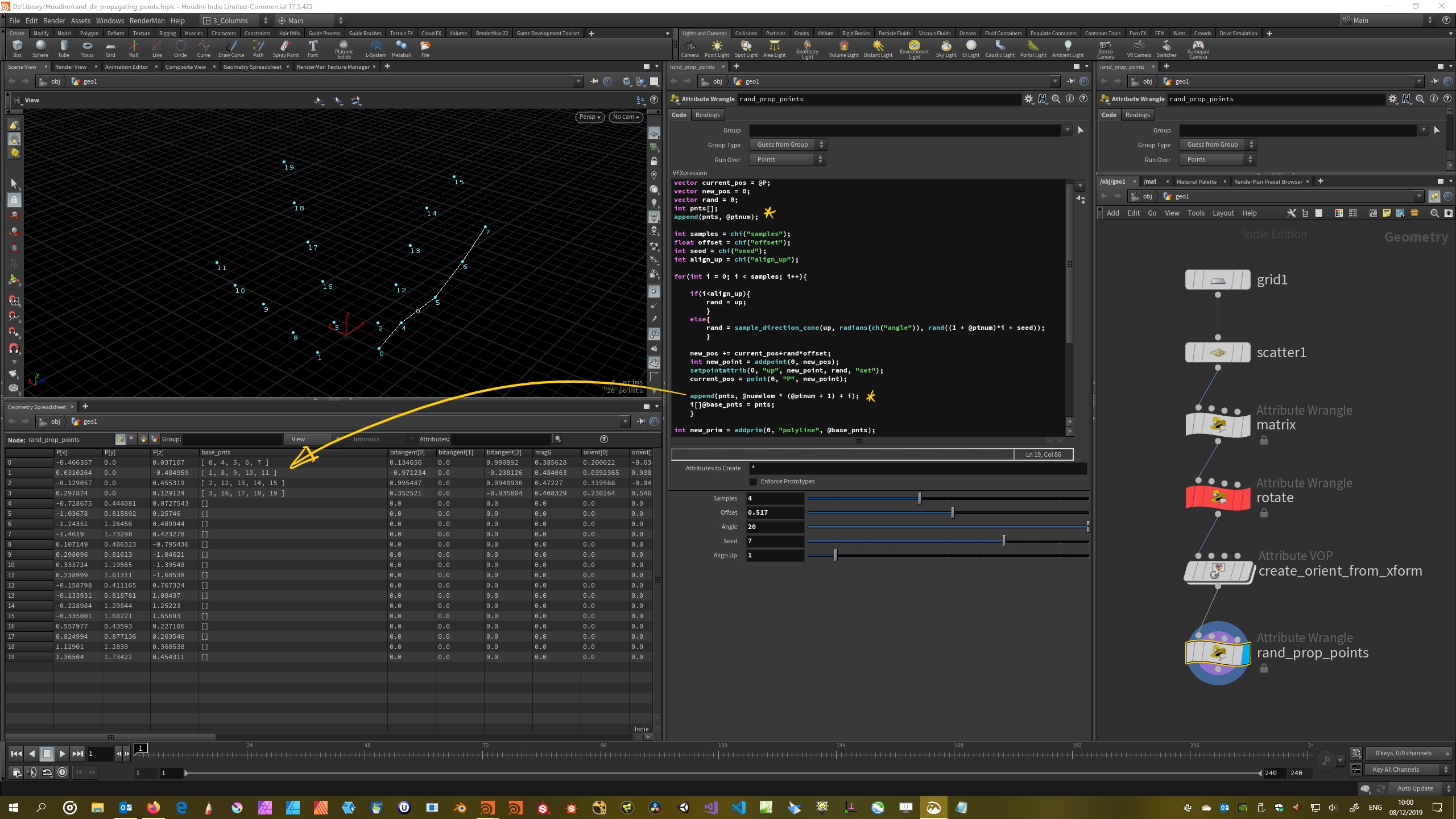

I didn't write in the post above, that I intended to later randomize the up vector direction for every new point and thus get a non-linear propagating pattern. I want to achieve a sort of (and I suspect that's not the right term here) parent-child behavior between every point and the next in line (something like tentacles constructed by points propagating in random directions). That's the reason why (in my head at least), calculating a new up by subtracting current_pos from new_pos and setting that at every sample is important.
Except, and this is probably going to seem totally dumb… at sample 2 it falls apart. Up is no longer pointing where I'd expect it to. I bet this has something to do with the last line current_pos = point(0, “P”, new_point);
It appears at sample 2, the up direction is pointing away from the world origin, and not away from the points at sample 1. I feel like I'm missing something so basic…
Edit:
Ok, getting somewhere with random vectors:
Edited by Haki - 2019年12月3日 08:23:20

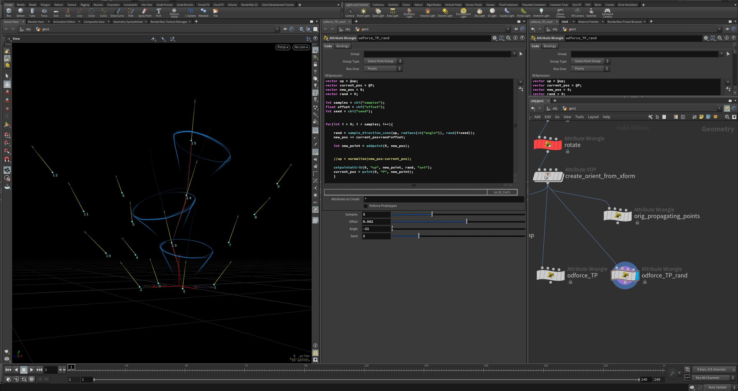

Hey folks, back with an update here, I took care of the curve framing:
Thanks to Entagma's Parallel Transport tutorial I understood the core concept here. I adapted it to my curves generator. I tried 2-3 alternatives, including the slideframe() function and the dihedral()*v0. Seems I got the best result by crossing vectors only. The slideframe and the dihedral seemed somewhat off, probably because I didn't do something right.
Here's the file if you wanna give it try:
With width and pscale attributes. Can be rendered as hair/fir now.
Edited by Haki - 2019年12月17日 08:59:26
