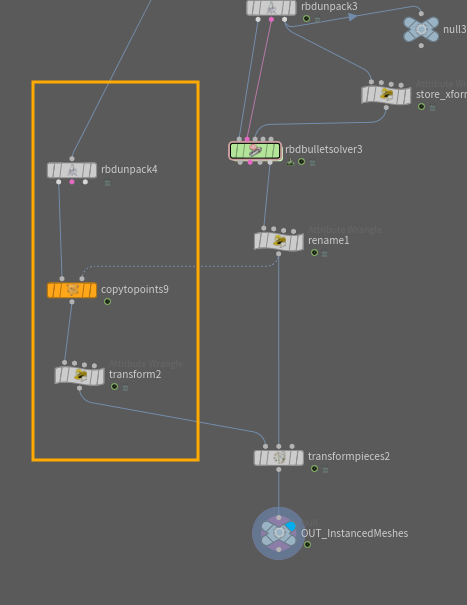

Sorry, I misunderstood your question.
The geometry output from the RBD Bullet Solver SOP is instanced already. However, if you plan on instancing your own geo on the points themselves you can do it using a Copy to Points SOP. You'll need a couple of things however.
You need the initial piece's intrinsic packedfulltransform and you'll have to modify the name attribute somewhat to retrieve the original piece's name.
The initial transform is necessary as the points' represent an offset from that initial transform.
