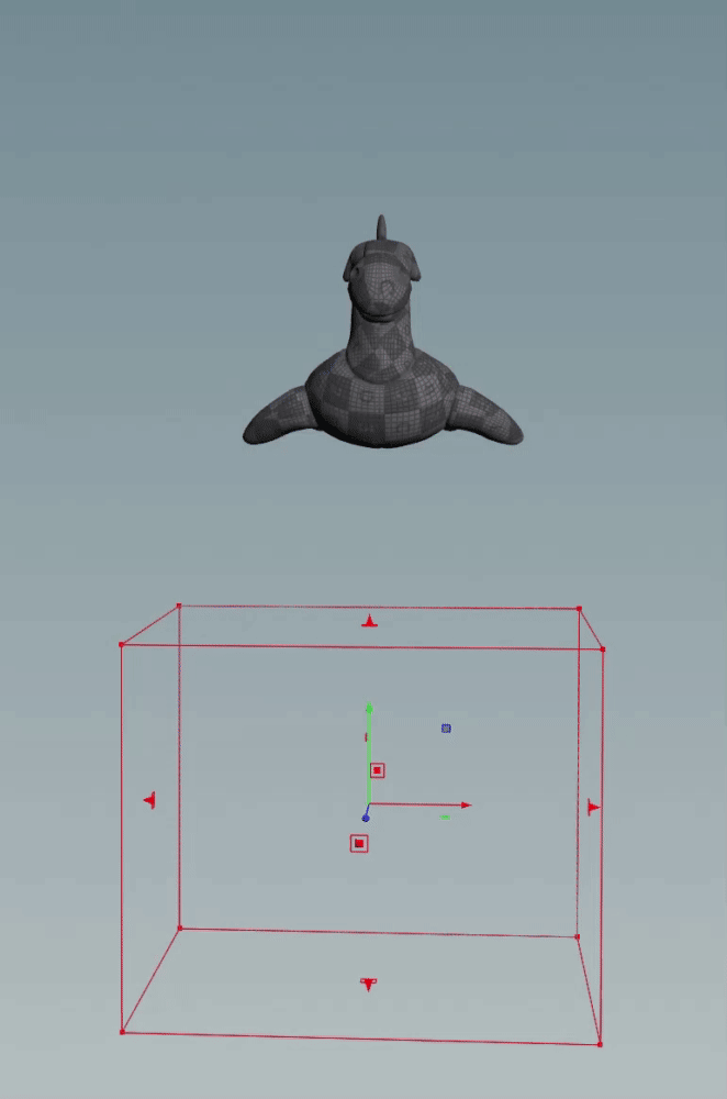

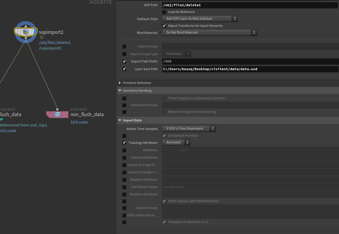

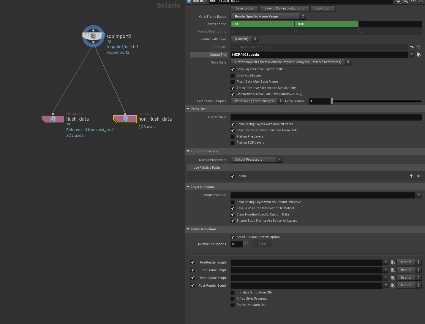

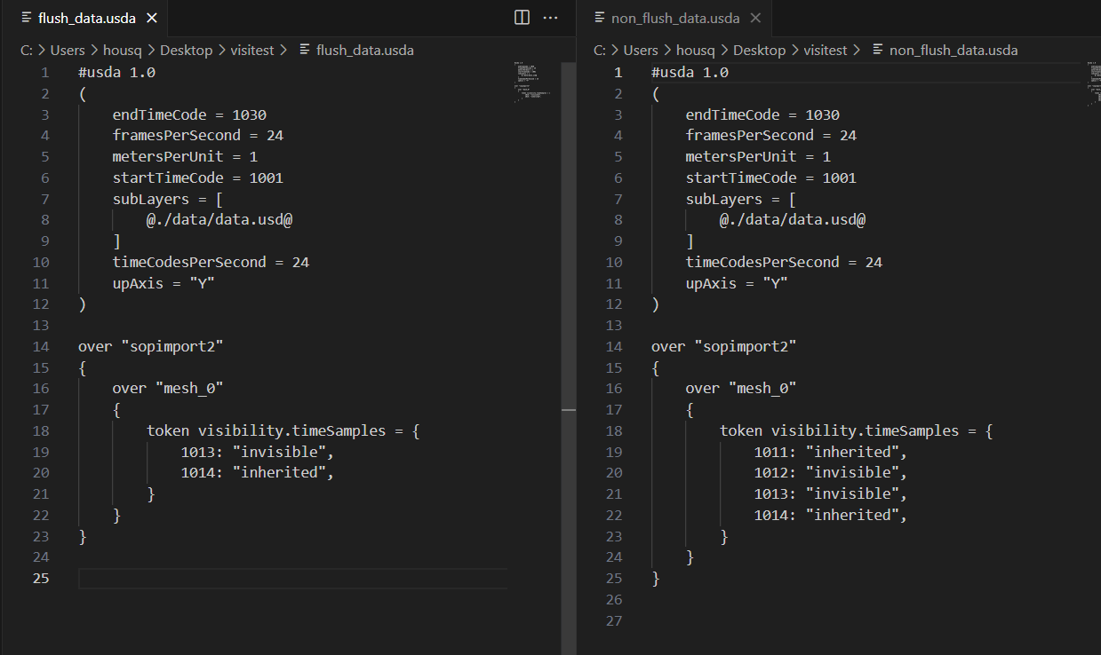

I am using this setting for USDA output. However, the visibility attribute loses some time samples depending on whether the ‘Flush Data After Each Frame’ option is used, causing the model to disappear. Did I miss any steps? Thank you very much for your help。

seems like a bug to me

Finally, I decided to manually import the bgeo cache into the lens using sop_import. Or cancel this option for smaller data. The reason I found this problem is that in the case of particles, artists may trigger situations such as deletion outside the viewport.
