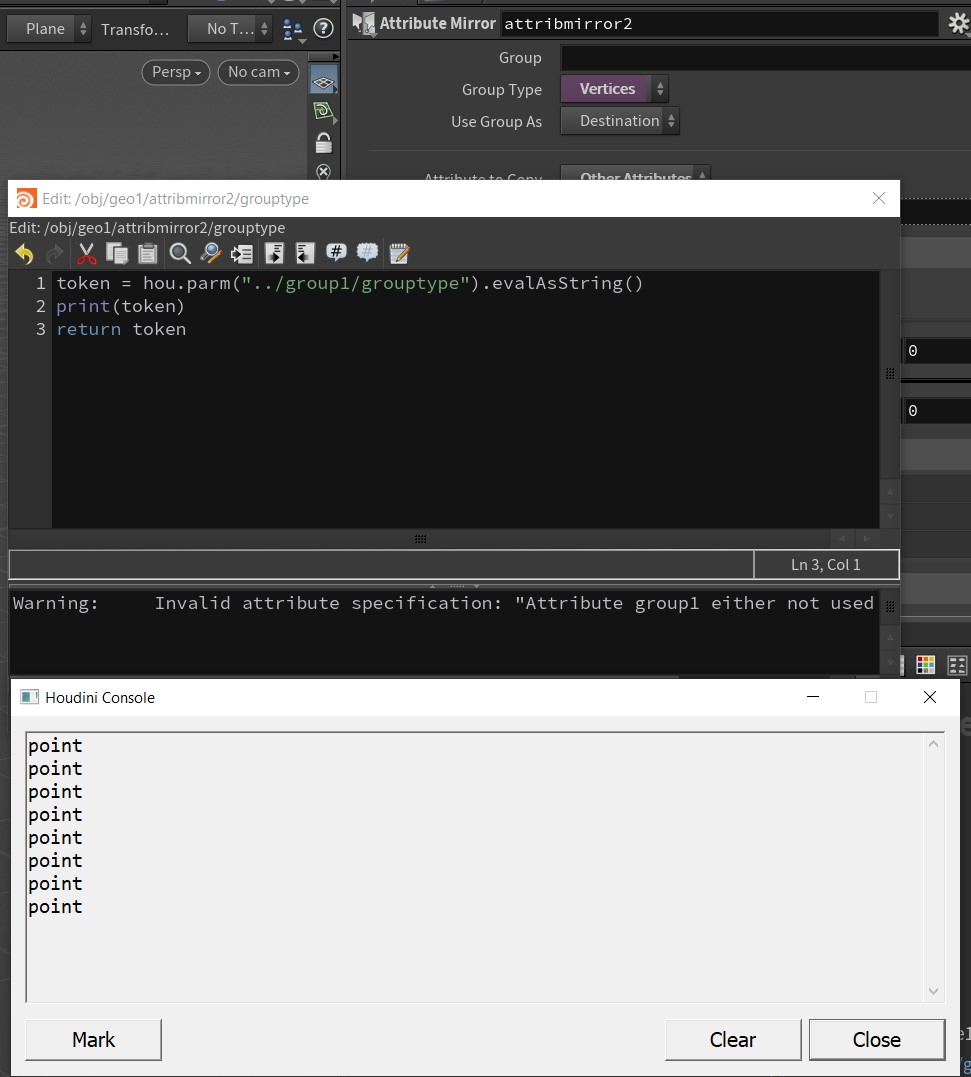

It's not the problem to get token value (in Python, evalAsString() as you said; in HScript, chs()). But the problem is that the ordered menu can't take an expression that returns string as its input.
So in my case, even Attribute Mirror can get the token value (via evalAsString() for example), I can't use the expression to set the menu value...
730 posts
Joined: 8月 2019
As the image shows, even the expression correctly gets the token ("point"), the ordered menu doesn't accept this string value.

I see what you're saying. These two menus have different tokens, that's why it doesn't work. "point" vs "points", "vertex" vs "vertices" and "primitive" vs "prims". The only thing these two menus have in common are their labels. So you would like to set them using a label, is that right?

Ordered Menu parms are integer, so you can't set them directly using string value, so:
1. for your menus, you can use String parameter with menu and then chs() will work
2. however for factory nodes especially HDK ones, where you can't change type from ordered menu or integer to string you can try something like this to figure out the index within current parm's menu
ref = hou.parm("../grouppromote1/totype1").evalAsString()
menu = hou.parm( hou.expandString("$CH") ).menuItems()
if ref not in menu:
    return 0
return menu.index( ref )

3. for menus that don't have compatible names you can also create custom mapping tailored to the specific parameter pair, so less generic, but that may not matter, in Hscript it would be something like:
atof( arg( "3 1 0", ch("../grouppromote1/totype1") ) )

Thank for all your answers. I eneded up using arg(). Surprisingly, Houdini seems to automatically convert string to int. It works even without atof().
