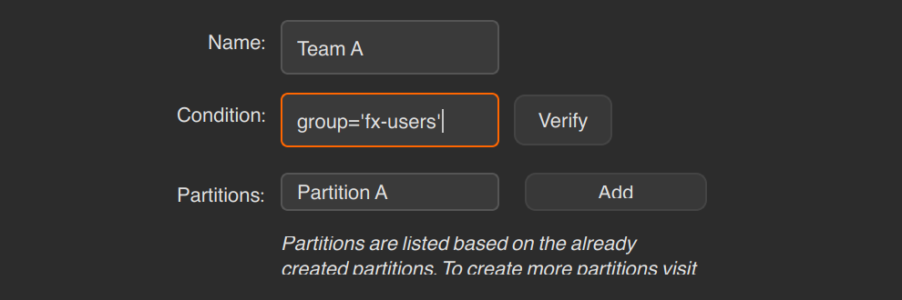

When you go to create Teams for license partitioning, you can add your LDAP group directly.
LDAP Condition Partition
The end-user will need to log into the License Administrator using their LDAP credentials in order to access the partitioned licenses as the license server will know what LDAP group the user is in. Note that this is a different login from the SideFX portal account (License Adminsitrator top right menu).
