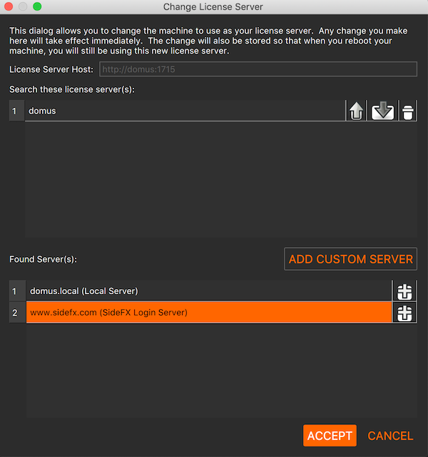

  3. Select File->Change License Server
  4. Under Found Server(s), select www.sidefx.com (SideFX Login Server) and press the + button beside to add.
  5. Under Use these license server(s), you should see the license servers you are now connected to.
In the following example, only the local machine is used for licensing.
Select www.sidefx.com in the Found Server(s) list to add to the Search Server(s) list.
The Search Server(s) tells you what servers are searched for licenses and in what order.
The Found Server(s) list tells you what license servers are found on the network to be added to the Search Server(s) list.

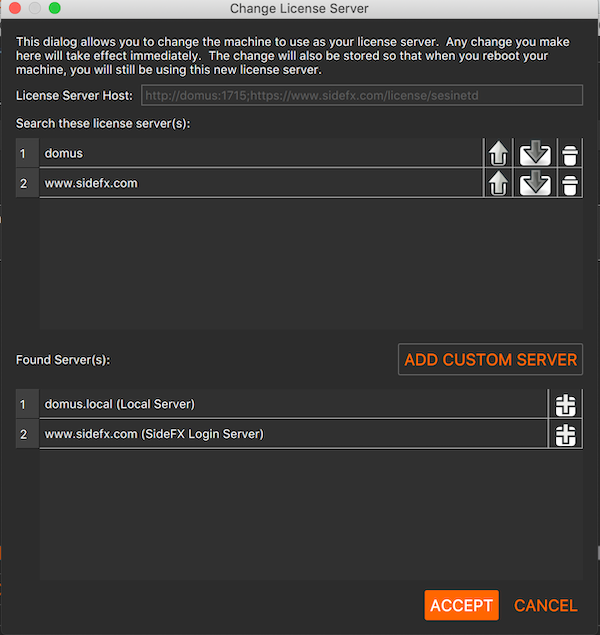

Login Based Licensing
Now both the local machine and www.sidefx.com are used for Houdini licensing.
You may change the order of which server is used first. Use the up/down arrows.
