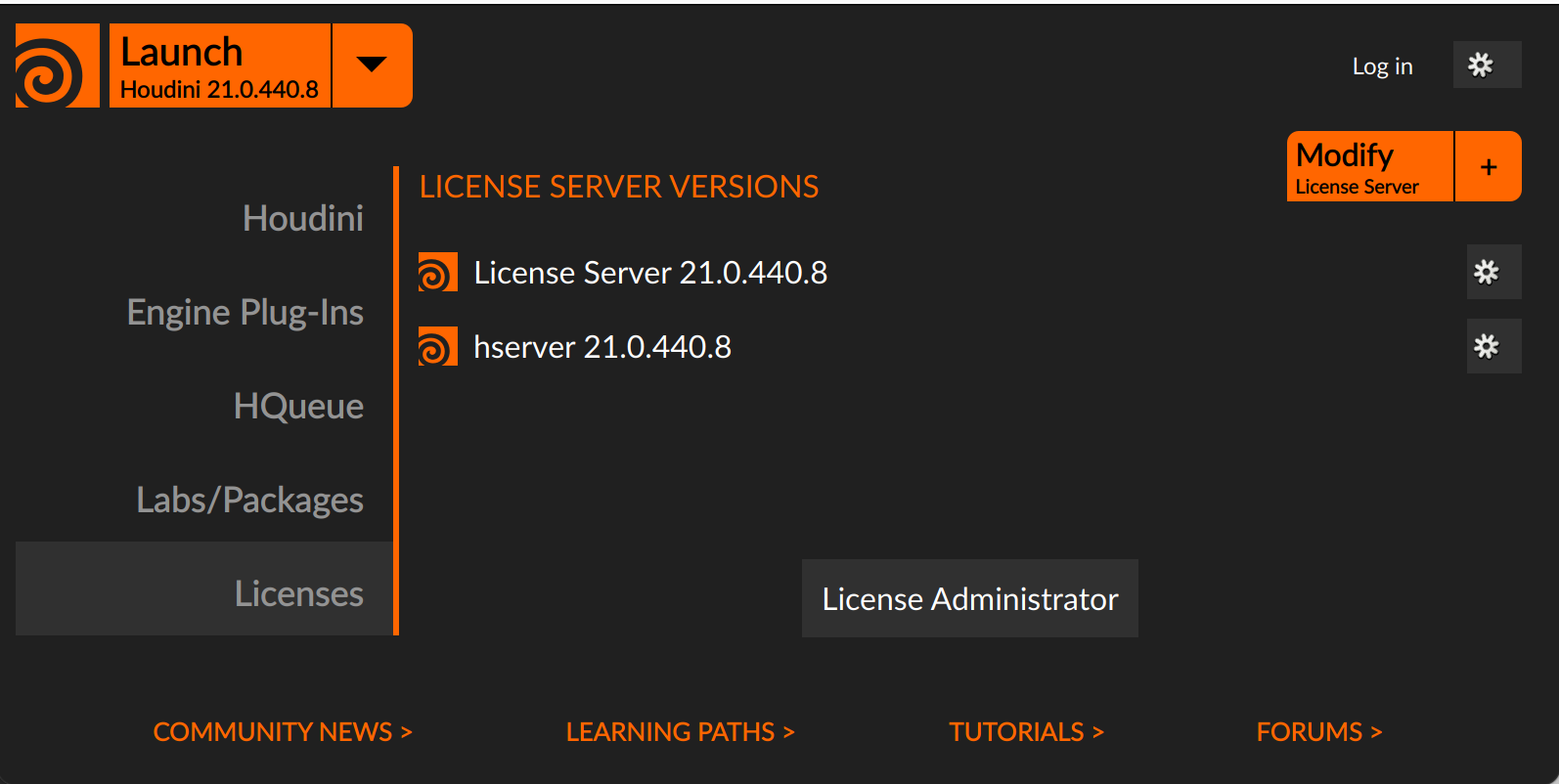

Using the Houdini Launcher, select the Licenses menu on the left then click on the License Administrator button.

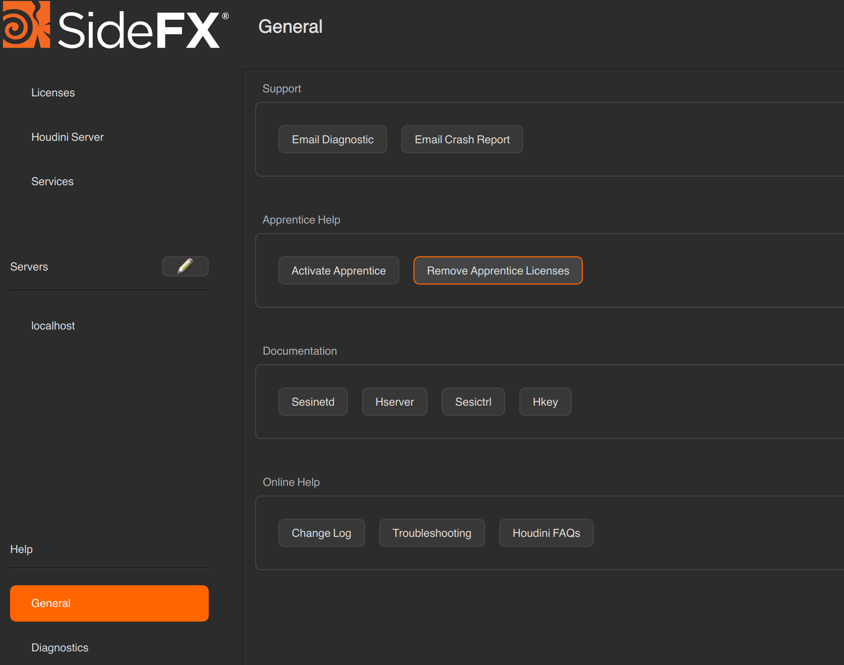

Navigate to the General menu on the left side in the License Administrator. Click the Remove Apprentice Licenses button.
